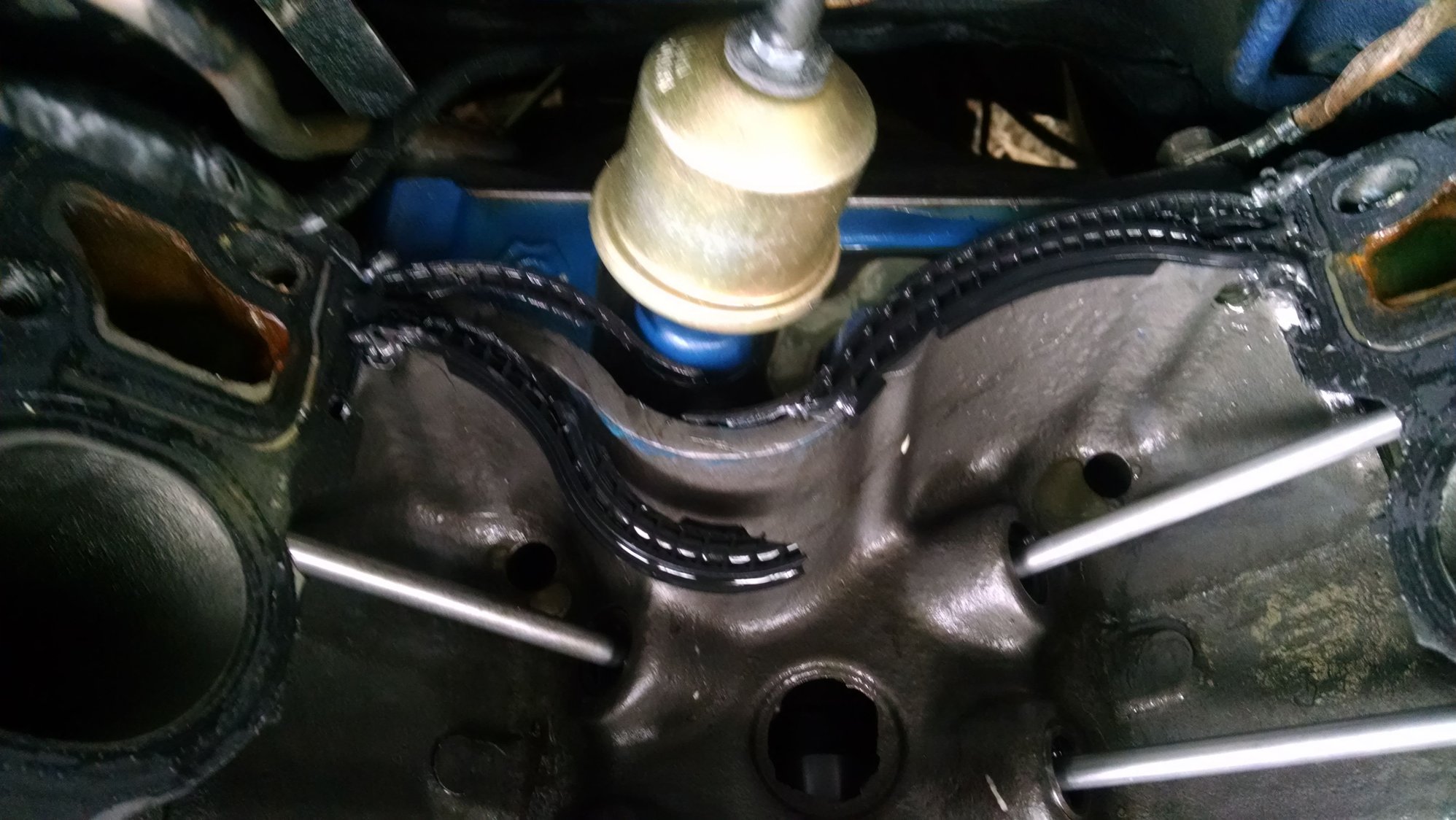

Found out where the oils was leaking from.
And also another one I hadn't noticed

Yea man. Thanks, I love it too. . just a current update, after reinstalling the intake, something went wrong with the oil pump driveshaft. I'm going to have to take the engine back out the truck, pull the oil pan and figure it out. Hopefully the few minutes I idled it trying to scratch my head didn't cause catastrophic damage. It sounded like sheet metal rattling so I was checkin the fan and water pump and blaming the PS pump and doing everything but checking the oil pressure. Dumb mistake.

When you put that intake back on I suggest not using the rubber strips on the front and rear. Just get a bead of rtv on there big enough to crush a bit from the intake and you will have a better troublefree seal.

I debated on just rtv, but decided to use the cork that came with the new gasket. I'm not expecting to pull the intake again.
I thought i was, thought i left tools in there. But I'm not quite sure what the noise was, at first I thought it was the putty knife I used to scrape the gasket. I couldn't find the putty knife in the toolbox, then I found it on the radiator, so that's not it.

Get 4 cheap bolts with the correct thread-pitch, hacksaw off the heads, and lightly screw them into the 4-corners of the intake mount holes. These will act as a guide and bring the intake down evenly and keep the china-wall gasket (or RTV) from moving-around while lower/seating the intake.

Great idea. That being said. When I put a new long block in the bronco I believe it had studs on 4corners with nuts holding it down. And that did go very smooth with that intake.
