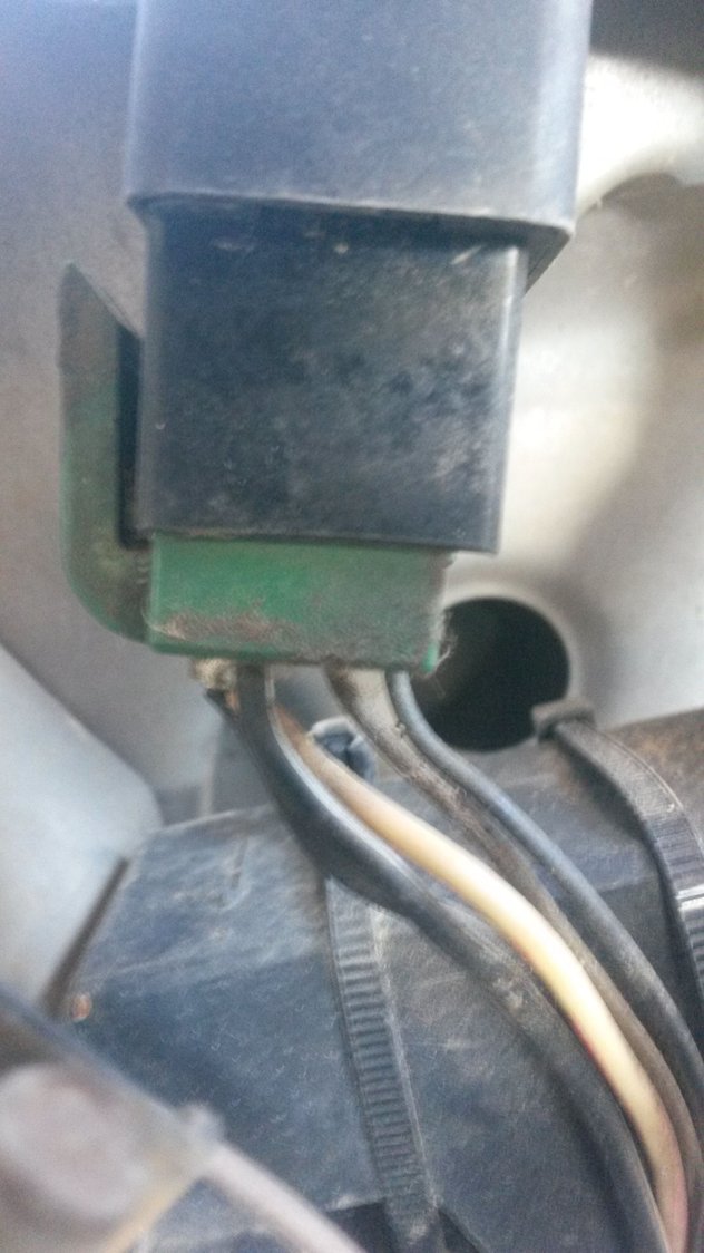

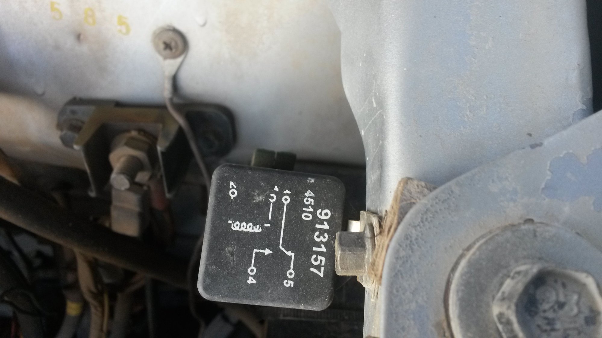

Below are the two pictures of what might be the relays you mentioned?
