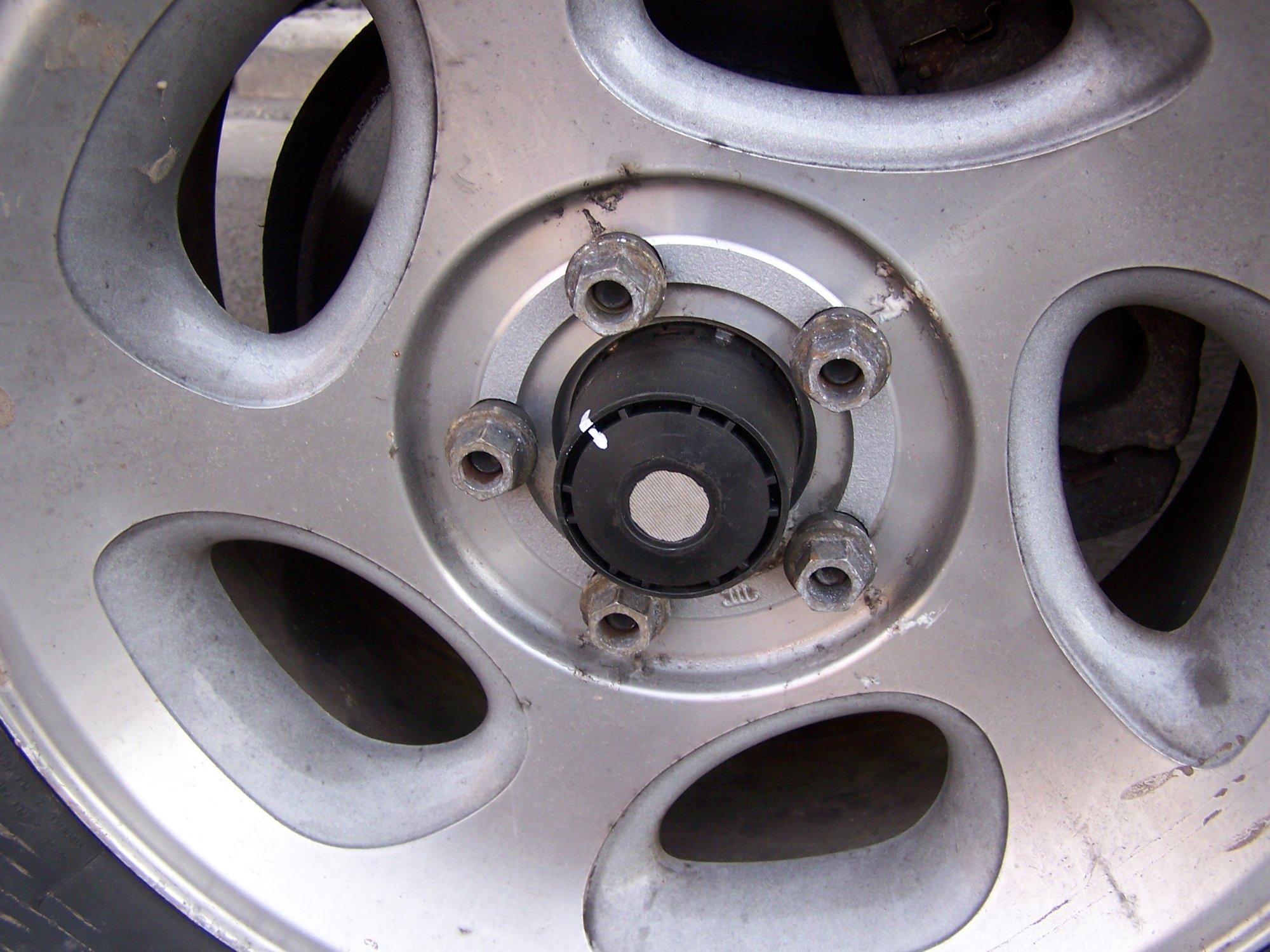

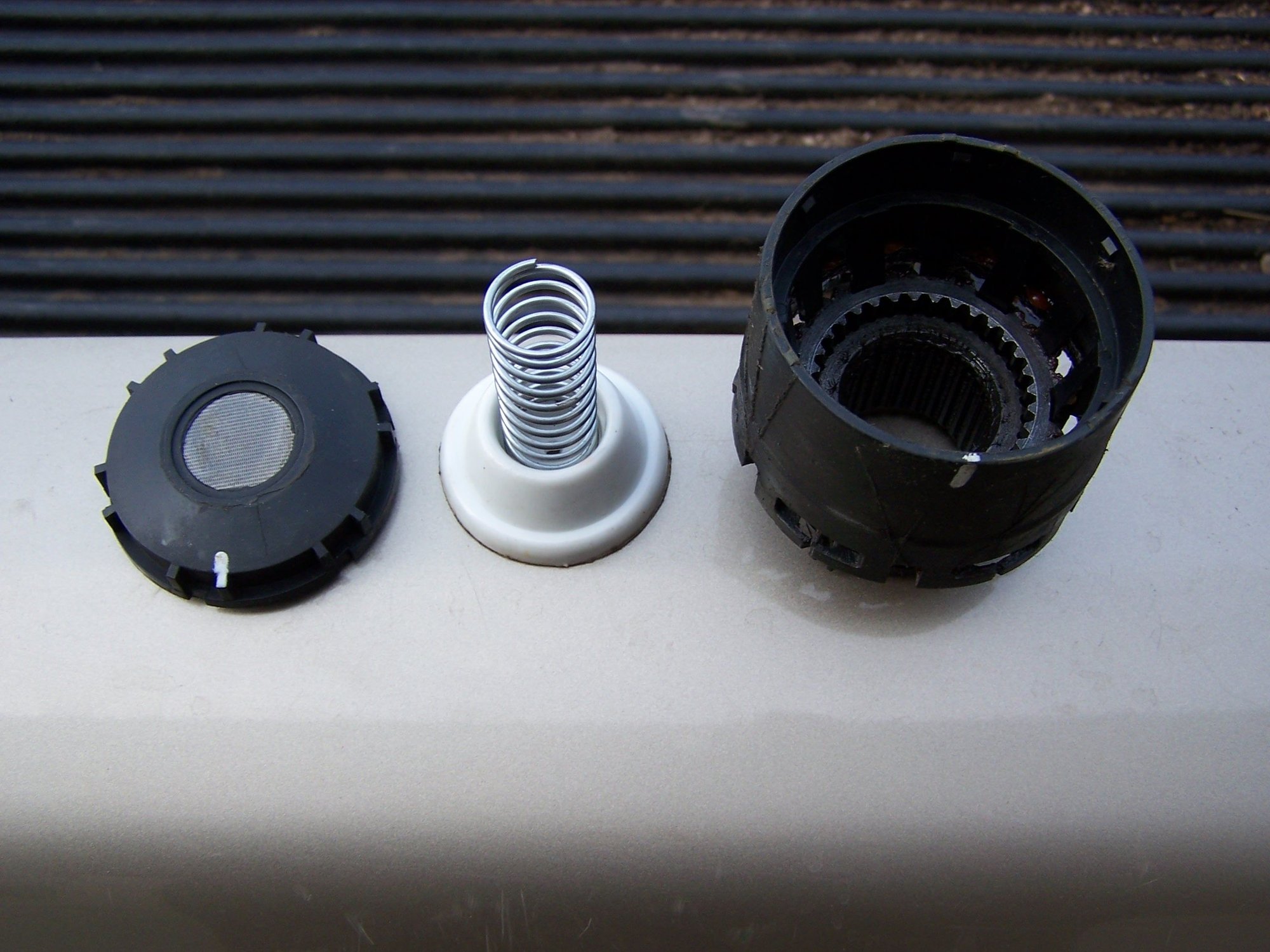

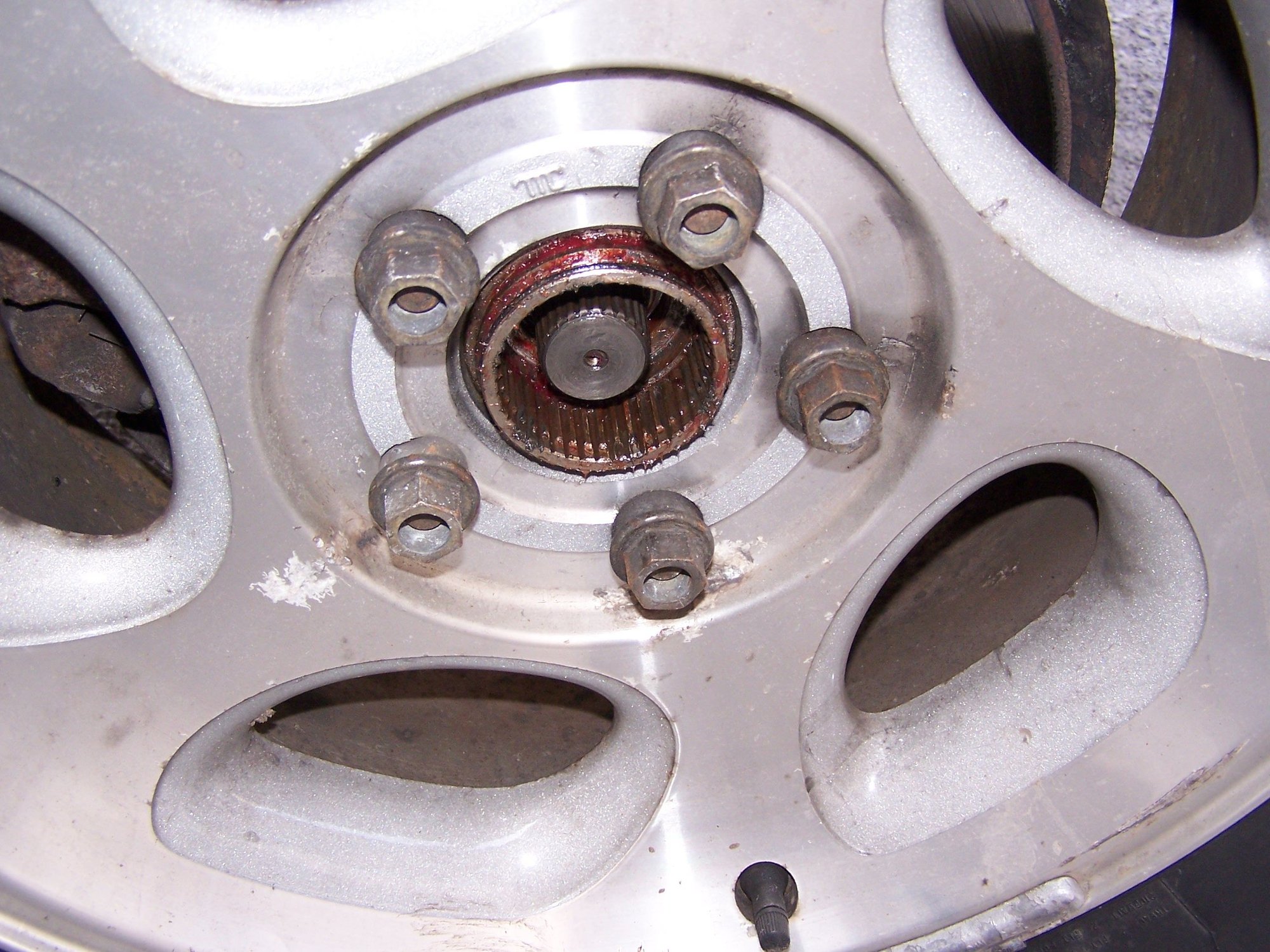

Pictures of Low Cost PVH to Manual Hub-locks
Here are the pictures of my low cost hub-lock conversion described above.
There is NO NEED to remove the entire PVH assembly from the hub when making this conversion. All you need to do is remove the vented cap, and the diaphragm and "clicker assembly" will come out, which are the parts that are not needed. The "doorstop" pushes the spline ring flush with the end of the axle, and that is what mechanically connects the axle to the hub.
Incidentally, I left my vacuum lines "as is" so that the truck would still think it was locking the hubs via vacuum, but I am sure they could just as well be plugged without causing any problems. I invert the "doorstop and spring" around to unlock the hubs. Since the vented cap comes off quickly and easily with use of fingers alone, I can manually change the hub-locks in about one minute total for both sides, including the time to remove and replace the chrome hub caps which keep dirt out of the hub-lock area.
