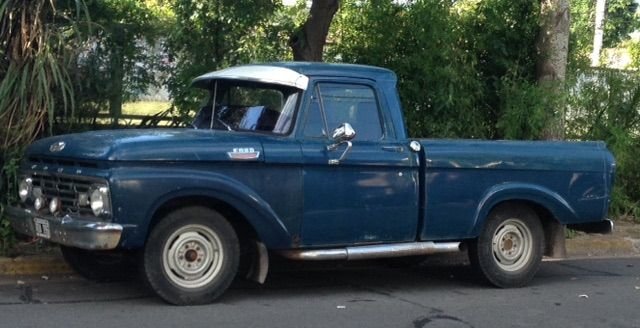

How about posting some pictures.

Old Feb 4, 2015 | 06:29 PM
Tedster9's Avatar
Tedster9
Joined: Apr 2002
Posts: 19,311
Likes: 97
From: Waterloo, Iowa
Sweet. Those visors are neat. More pics pretty please?

Is that one of the south american non-unibody's?

Yes more pictures of the visor and the rear of the truck. Nice! And welcome to FTE

Love the side pipes but that visor is not right.
