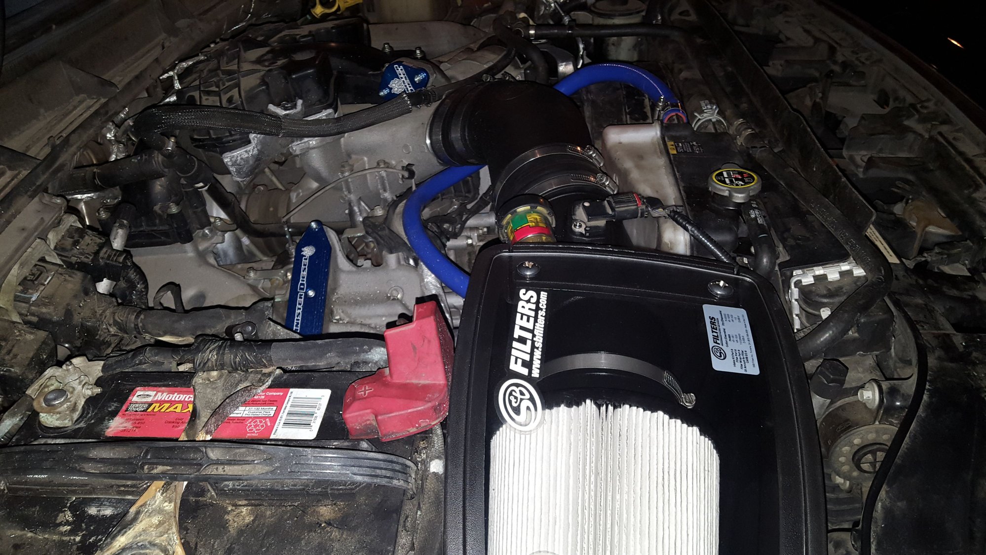

Deleted today! 4" flo pro w/muffler, Sinister deletes, SB cai, min max race tuner. This is like a whole new truck!
Added some LED door sill panels too. Activate with the door opening.

Looks great! How is the shifting with the mini? What tunes are you running?

Shifting is fine but the trans is relearning so I will have better review of shifting afterwards. Running it on performance tune (not for towing). Im not sure the actual file name or if it is a custume tune. Diesel tech is former Ford and H&S tech, said he updated everything.
