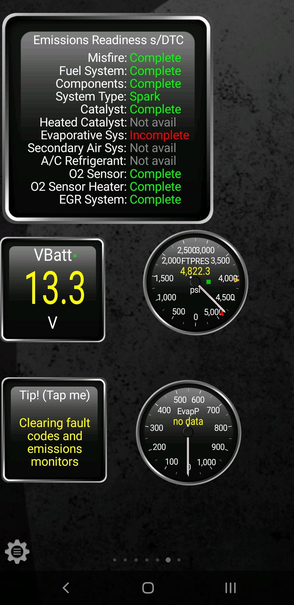

So, in my 2003 Expedition, I am looking at everything because the EVAP system is never completing. I first had a P0446 code. I fixed up the Vent solenoid. I now have a P0442 code.
I am seeing an odd value for what I believe is Fuel Tank Pressure. It shows to be nearly 5000. I am pretty sure this is incorrect.
In my opinion, this would NOT be from a leak. Rather, this would be from a defective part.
Torque reading of FTPRES (Fuel Tank Pressure)

You're likely beating your head unnecessarily against a wall if you're trying to get the vehicle ready for emissions testing. Most jurisdictions allow at least one "incomplete" monitor as long as there are no fault codes.
The "data" you're seeing in Torque is undoubtedly due to a faulty formula. The only way you'd see 4800 psi pressure in the vent system is during an explosion event.

If you look at the scale that's built for the Torque Pro app's Ford FTPRES PID , I think it's a 0-10 scale. I went out and looked at my '03 Expy's FTPRES in Torque Pro and it's pretty steady at 4.9 and I have no DTC codes. Like Project said, if you ever actually had 4800 psi in that sensor it would be in some type of catastrophic explosion as the Expy was turned to schrapnel. So, I don't think that sensor is your problem. I think who ever made up the Torque app plugin didn't get it right. Some people say that that sensor is really just sending a voltage from 0-5v to the ECU and the higher the voltage (closer to 5v ) the lower the tank pressure. I took my gas cap off and it didn't change the value, so I'm inclined to believe that 0-5v scale. So actually what's being read by Torque is a voltage number, not a psi number. So 4.8-4.9v is probably normal and low tank pressure. If you go into the Torque Ford FTPRES PID and change the scale from PSI to Volts you'll see, and you'll feel better. Oh, and my EVAP System shows incomplete most of the time as well on the Torque app. I'm not sure it's set to read the ECU correctly for that. Because other scanners show the drive cycles and EVAP tests as completed. So don't ditch your Expy on readings from an open source app like Torque. I usually use my Ford IDS3, Auto Enginuity laptop scan software or an Ancel FX6000 to look at live data on our vehicles. I really only use the Torque app as a temporary or quick look at a DTC code if I have nothing else with me. Do you have access to a mechanic's smoke tester ? That would help find any leaks too.

At atmospheric pressure, the FTP sensor should have an output voltage of about 2.5 -2.6 volts. Keep in mind that his sensor is designed to measure very small changes in pressure and vacuum. If you'll notice, the unit is in "in H20" or inches water column. [https://en.wikipedia.org/wiki/Inch_of_water]. There's a reason that, for leak testing, you aren't supposed to pressurize the system with more than a pound or two of pressure.

At atmospheric pressure, the FTP sensor should have an output voltage of about 2.5 -2.6 volts. Keep in mind that his sensor is designed to measure very small changes in pressure and vacuum. If you'll notice, the unit is in "in H20" or inches water column. [[url]https://en.wikipedia.org/wiki/Inch_of_water]. There's a reason that, for leak testing, you aren't supposed to pressurize the system with more than a pound or two of pressure.
Project I agree. I went and looked at it with IDS and it's right at 2.53 volts. I think the $4 Torque Pro is just messed up with this PID and it's causing a lot of headaches if that's all you're depending on for your troubleshooting. I very rarely use it. Just in emergencies if I had nothing else. But I wouldn't rip my vehicle apart over anything Torque gave me.

Attached is the PID config and it shows what is listed for FTPRES, and what Hamfisted described. It is listed as PSI and MAX of 10.0 and MIN of 0.0. The equation is ((A*256)=B)*0.1449. I agree about the values and the explosion part. This whole "adventure" has been a pain. I'll try reloading the Plug-in. Even re-load the App if I have to. I just changed the PSI to Volts. I'll test it in the AM.

As for the Torque formula and the units, there's something wrong with the implementation. It's probably a red herring at this point based on the limited data presented. I don't know how to fix it, but I can see enough to know to ignore those numbers as presented.
There is no valid data supplied that indicates the FTP sensor is defective. Possibly another rabbit trail. The whole premise of this thread is based on a shaky "diagnosis" or, more likely a guess.
