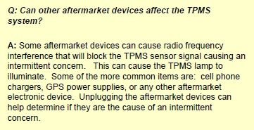

50gtconvertible - Has anyone have one of these TPM modules go bad? I recently did a timing chain on my 2011 Ecoboost, and afterwards the TPMS sensor light came on and wont go away. I tried the relearn method using the hazard button, and ignition / pedal method after replacing the supposedly bad sensor and the light still won't go away. I even purchased the relearn tool to program the new sensor and that still didn't work. I even went to the Sam's tire center and Discount Tire center and were told by both that the replacement TPMS sensor works, so it must be an computer issue. Has anyone had the same problem?
If the TPMS sensor is Motorcraft it could very well be (excerpted from the Ford Motorcraft TIRE PRESURE MONITORING SYSTEM document) ...
If the TPMS sensor is after-market you're more than likely SOL and at the mercy of the maker.
BTW... The battery life expectancy of a TPMS sensor is 5-8 years depending upon the mileage. *They're only -ON-/active when the wheel is in motion.
