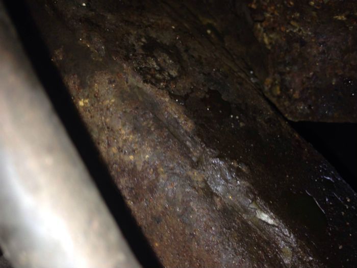

Here are some pictures I took. The frame has surface rust, but doesn't have holes. It looks like someone rigged together the steering box, maybe added a metal plate. The frame has surface rust, like I said, but I picked at it and it is solid.

Looks like someone's already tried plating over it there. Didn't do too good of a job either. And that stack of washers on the bottom bolt is just
I would cut that crap out and redo it. Reminds me of some similar "repairs" that I found after I bought my truck. The PO had welded some really thin metal over a crack in the frame... I was pissed but only because he didn't tell me about it.

Wow, that is a HACK frame repair if I ever saw one.
I see it was a pow truck too.
I suggets taking the truck to a REAL welder and have him cut that crap off and make a suitable plate
