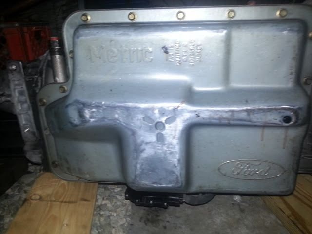

I have a transmission that I bought that didn't fit my 97 F250HD. I know it's for a small block and has more sensor connectors than mine did.
I need to find out what this transmission is and what it came from so I can hopefully track down the guy who sold it to me, or try selling it myself to get it gone.
It has a metal tag attached to it but some of the lower numbers are no longer there.
This is what's left: 1C (very large) XL7P-AA
PRB-BF1
00082016
??-9F07
Then on one side it has: RFFS1P-7006-AA
Then other side it has: RF-XL3P-7A040
Any help with this would be great and can anything inside this tranny be useful in my E40D transmission, because my salvaged one is already giving me problems.

A photo would be very helpful.

How many bolts hold the pan on?

Here are some pictures if I did this correctly. Pan has 20 bolts.

It is a 4R100, not an E4OD. I can't tell if it has the modular or the diesel bolt pattern on the bellhousing.

The secret identifier is the turbine speed sensor. The E4OD doesn't have one.
You can install a 4R100 in place of an E4OD. There is a mod that needs to be done in the pump body or the converter lockups will be VERY firm. You can run it with the firm lockups if you prefer.

I finally made it over to my local Ford dealer yesterday to find out what it came out of.
The numbers come up that it is for a '99 Expedition w/5.4 liter engine.
I had him check to see if it also would fit a F150 5.4 liter, but it came up with different numbers.
Is it that important that it goes into only one model?
