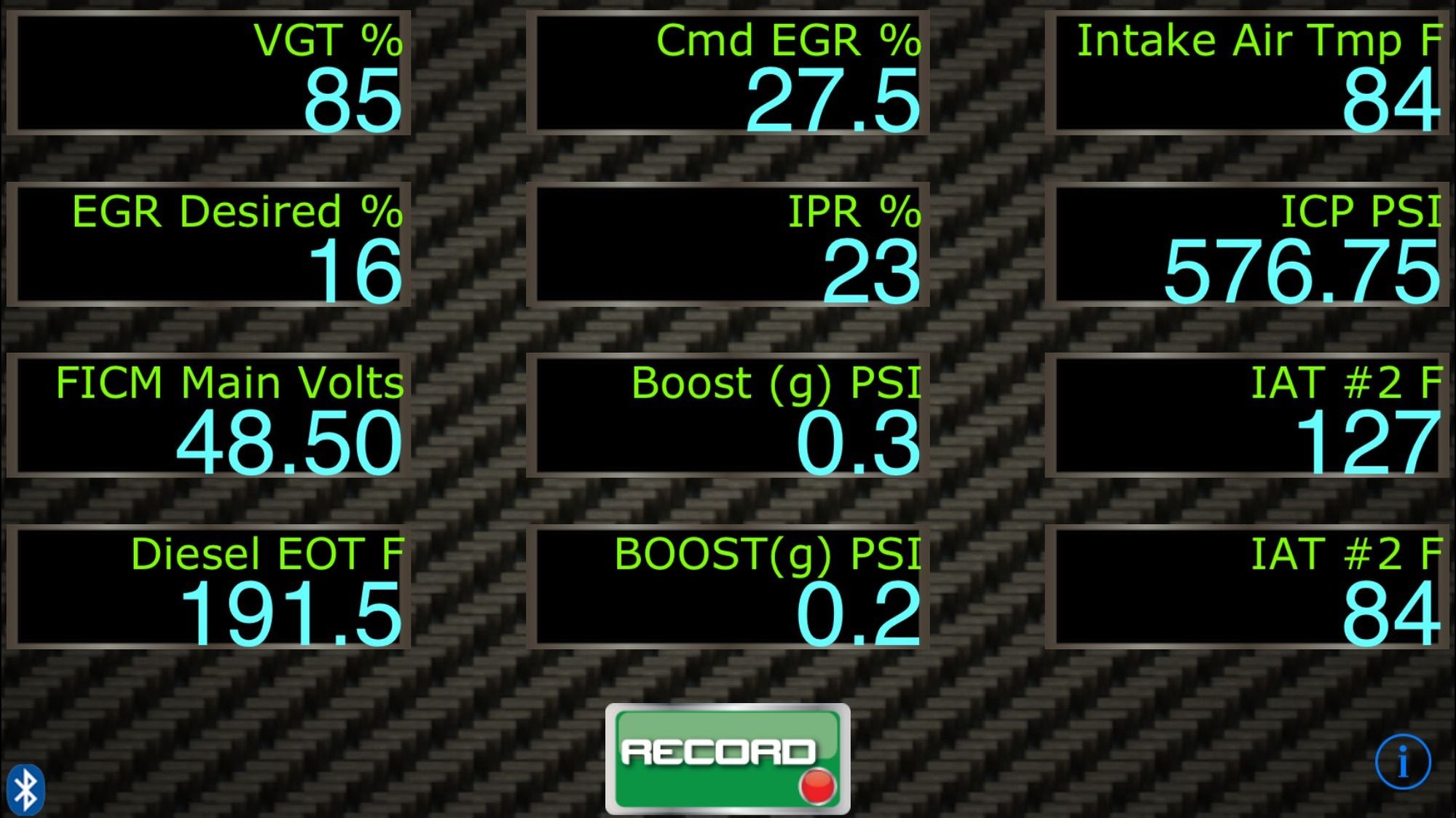

What's ipr% at hot idle... eot over 185f
Old Jan 4, 2015 | 10:03 AM
  #39
250andEX's Avatar
250andEX
Joined: Dec 2014
Posts: 152
From: South Carolina
Hot idle it doesn't
't always happen and im not sure about the IAT's because it list 2 in the dashboss options but obviously one isn't right. Not sure if it a dual element and try's to show both and one is bad or one is mislabeled. initially the inlet air and the iat that reads the same were not reading the same

There are 2 IAT. One is a part of the Mass Air Flow sensor and the second is in the intake manifold as a separate sensor.

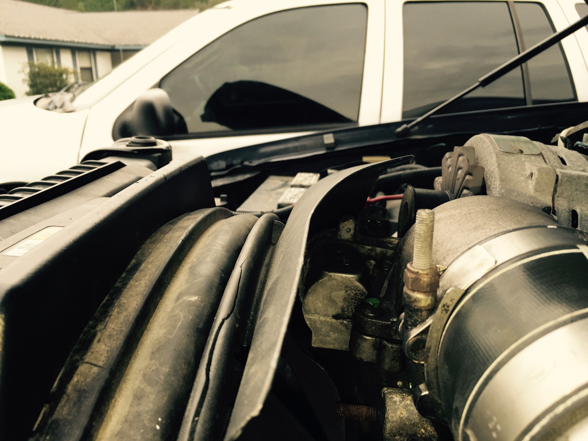

for all those lucky enough to get the 04 updates with the egr throttle plate it isn't needed until its needed. Finally unplugged it and all problems went away. I need to find a P&ID for the egr system to understand what was going on. I thought is simply let the egr valve have more or less exhaust gas to work with . I must be wrong. thanks for the help everyone

Connector that worked
hers a pic of the connector

That's why guys are taking the Butter Fly out it wouldn't matter, yours must have been stuck in-between open /closed. So How she running now after finding this and what EGR PIDs do you need?
