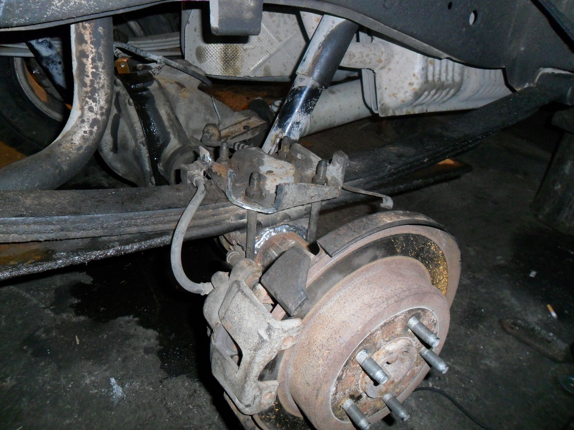

seems to me I have first quation
I wanna leave old pearches as they are and weld new on top of axle. Must they be paraller to old?
Old Dec 29, 2014 | 04:43 PM
Pablo-UA's Avatar
Pablo-UA
Posts: 5,242
From: Kiev, Ukraine
Now it looks like this. Doing brake line work now
Old Dec 29, 2014 | 04:44 PM
Pablo-UA's Avatar
Pablo-UA
Posts: 5,242
From: Kiev, Ukraine
But now park brake parts look like a puzzle for me.
Any things about compatibility of park brake cabels of explorer and ranger.....
