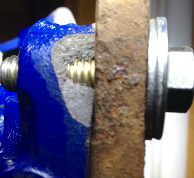

So a friend of mine is helping me do some things I know little about. I bought a rebuilt 302 and had it home for thirty minutes. Used the wrong size bolts on the engine stand and........CRASH. Now I have to keep my friend away from sharp objects for at least 72 hours. The tapped bolt hole {below the locating pin } sheared at an angle leaving enough threads to still bolt to the engine stand. My friend said it will be fine. I know he would not deceive me but I wonder if he's just too hopeful. What do you guys think? I would rather hear it now!

IMHO, it won't matter. But me being me, just to make me feel better and not that it would matter, I'd put a couple dobs of JB weld on it and stick it back on, being careful not to get any in the threads.

I'd put a longer bolt in and put a nut on the back side, after flattenning the back side with light grinding.

The cast iron can be successfully TIG welded by a certified welder with experience. My friend, a major pro racing engine builder does it all the time, puts blocks back together after a rod goes thru the side. I'd suggest contacting the largest racing engine builder within driving distance.

It probably wouldn't matter, but I would do like Ross suggested. Good luck & Merry Christmas.
That really is a good idea.
Let's just say I have (ahem) personal experience dealing with a similar situation...
I'm with Ross also on this one.

Hey everyone, thanks for the quick responses. I woke up this morning with a dark cloud over my head. Feeling much more optimistic now. You guys saved Christmas! Assuming that it is a mere flesh wound and the area around it is sound, I have a second question. I am going with an auto transmission. Will those mating surfaces be dry or will I have to worry about fluid leaks?
This is the right way to do it, I don't think it will need to b an engine guy though. Most of my local AG guys are better at welding cast simply because they do it on tractor cases A LOT. I would weld it, re-drill and tap it, if it were mine. Most local AG machinist won't charge you an arm and a leg either.
