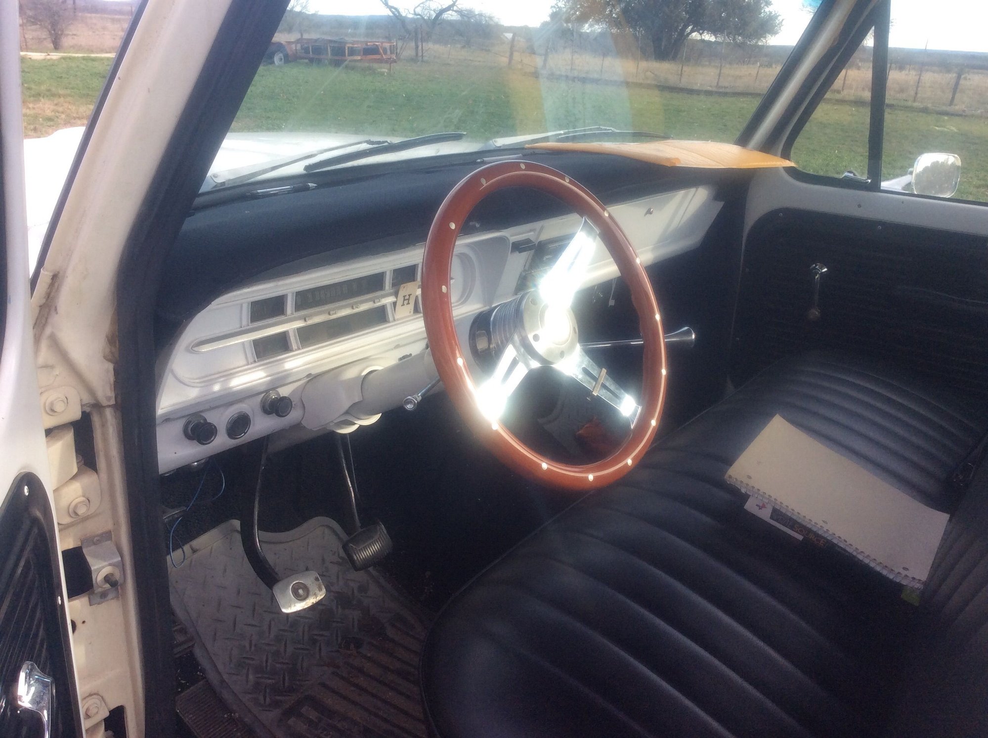

I'm wanting to put power steering in it and a front end out of a 73 with power brakes also.

Nice truck. Note, the clutch and brake pedals take the same pedal pad still available from Ford. Part number B7A2457A.
Haha I still have the one that came off just haven't got around to putting it back on. Very observant.
