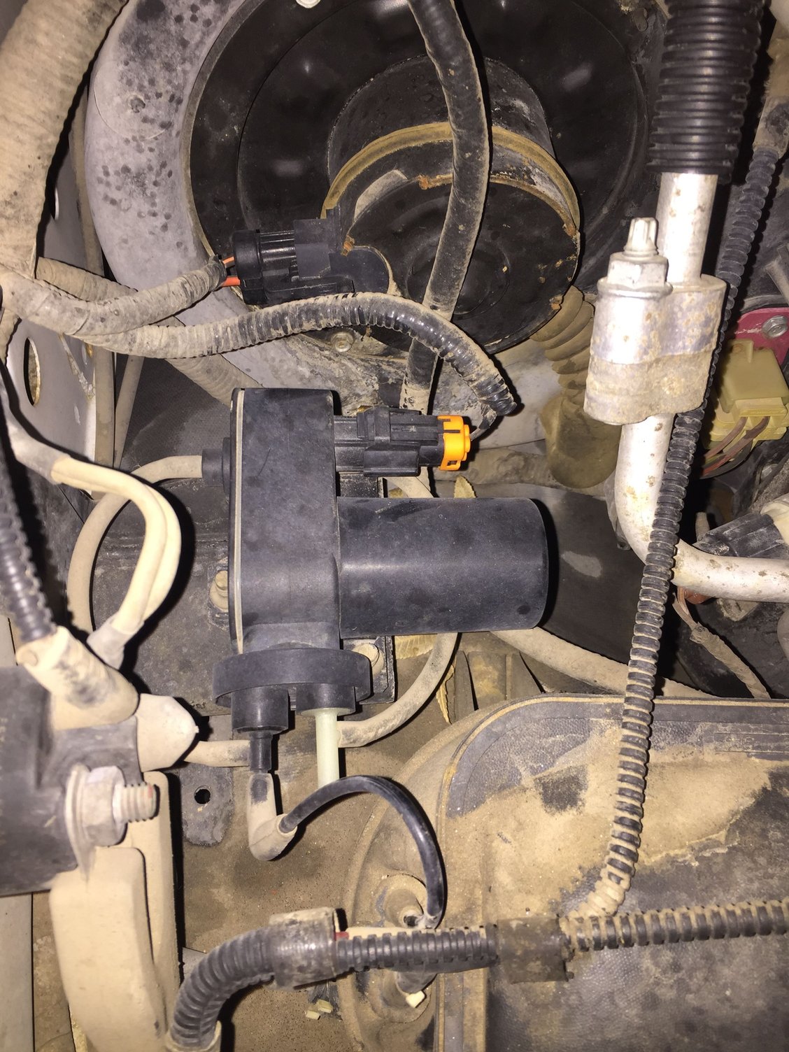

Ok guys, I am new to the diesel thing but have been working on cars for a long time. I have 7.3 Ex and have done a few simple mods to it as seen by my signature. Today, I drilled out the banjo bolts on the ends of the heads. After I got it buttoned up, it wouldn't start. I charged the batteries and it finally started but it running rough. I have no codes and no other mods than the ones in my signature. During the no start period, this guy was making a whole lot of noise. I have no idea what is, again, new to the diesel thing. Should I not have drilled those banjos out? Any idea why this pump was so noisy? Any advice or direction you can offer would be great. Thanks!

Drilling banjo is ok as long as you de burr and that is a vacuum pump

Yes I did deburr, they were both nice and clean and smooth. I thought it was the vacuum pump but I expected something...bigger lol.
So would the rough running be a coincidence and not the result of the banjo drilling?

Air in system
