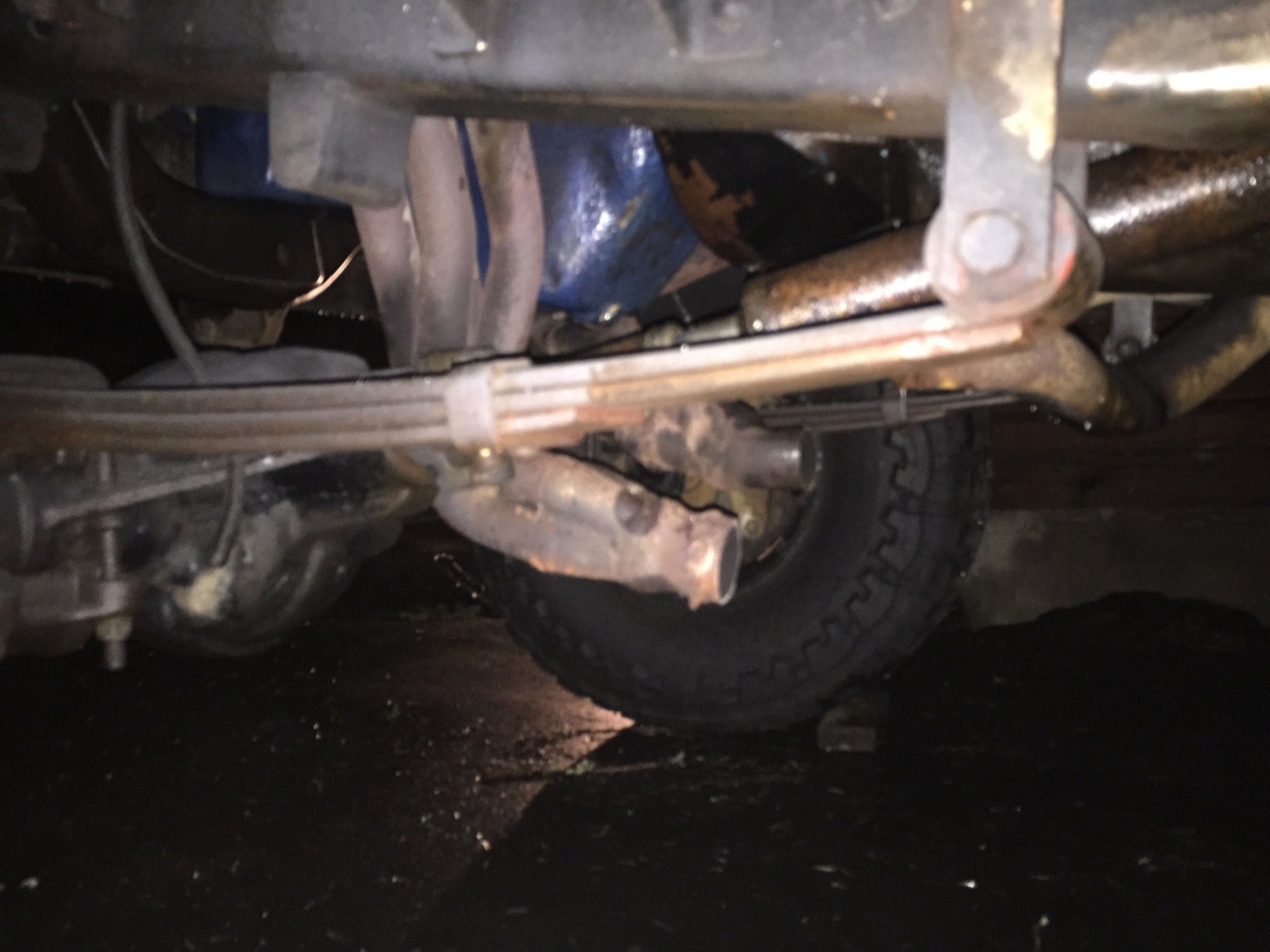

Had to get it towed back to my house after spending a few hours trying to do a quick header change before the rebuild. But after breaking off too many bolts in the head, I had to call it a day. The previous owner installed some terrible headers and welded the collectors together to fit.
This is what they look like after I cut hem off In an attempt to remove them

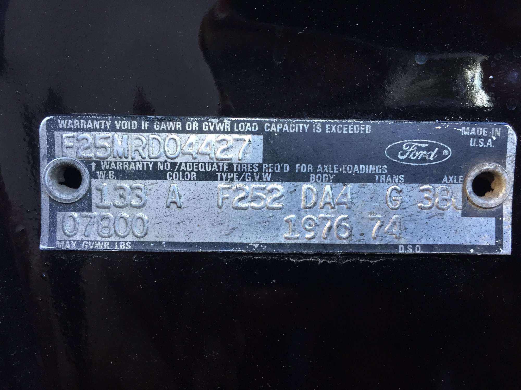

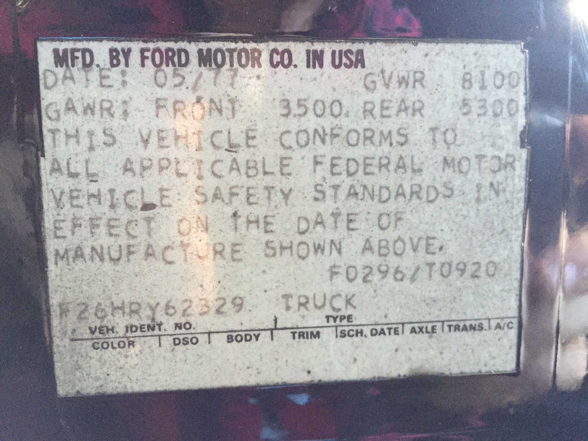

I've noticed that the driver door never shut as smoothly as the passenger door and after further inspection I saw that the driver door had a diffrent warranty plate. So I orderd a marti report along with a new warranty plate to make it look original
I'm hoping you ordered the report and tag for the F26 vin number. That F25 vin is for a 2 wheel drive.
Also since your door tag is wrong make sure you check the vin on the passenger top frame rail, between the cab mount and radiator mount against your title. It is usually closer to the cab mount.
I checked the frame rail before ordering and the vin matches the one on the cab

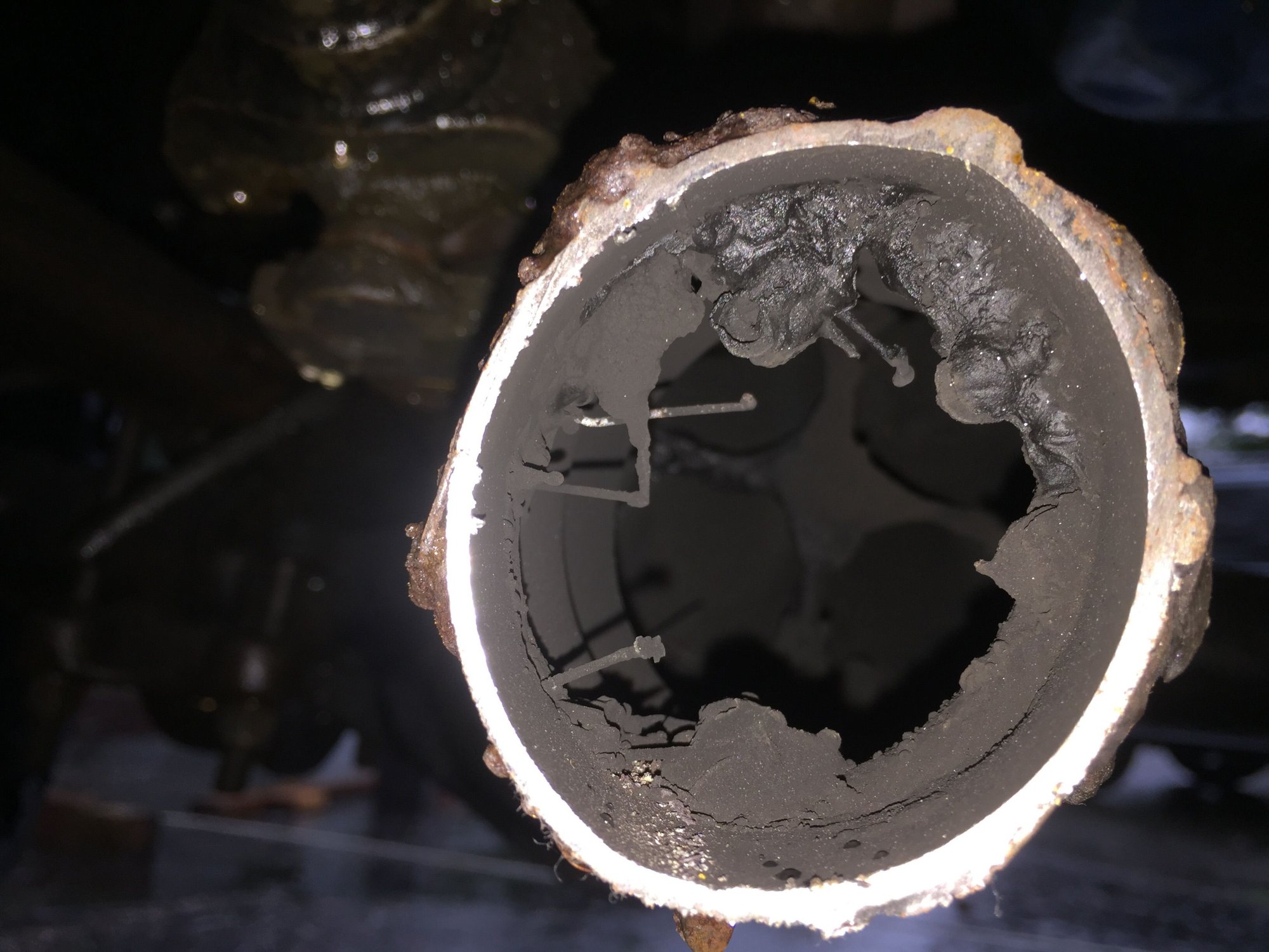

I took a look up the collectors and found this
Old Dec 21, 2014 | 01:38 PM
HIO Silver's Avatar
HIO Silver
Joined: Dec 2009
Posts: 20,678
Likes: 83
From: NorCal
Yeah, that's the result of improper gaps while fabricating - a poor attempt to fill a crevasse with welding wire.

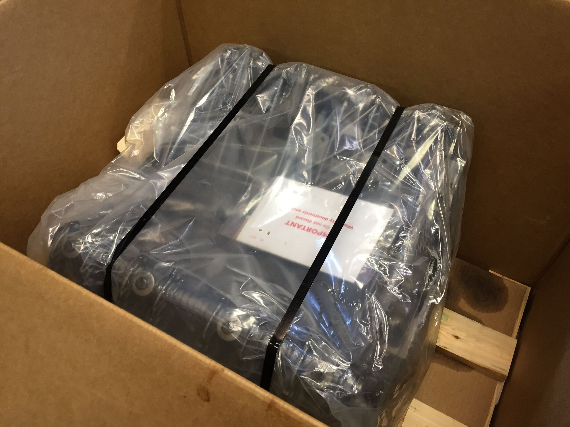

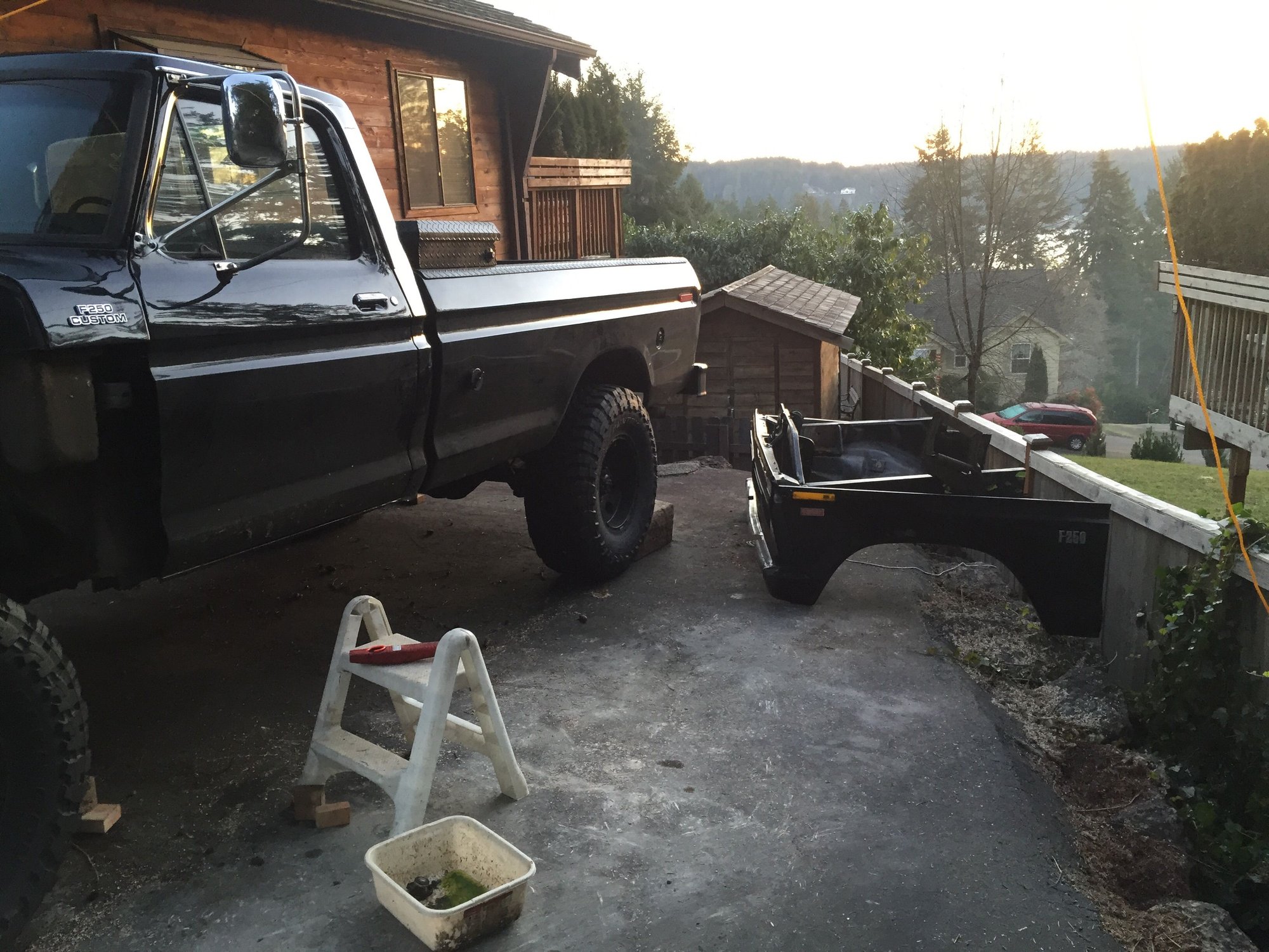

It has been a while since I last posted and lot has changed. I have decided against rebuilding the motor in my truck and instead buying a 390 long block from a company a couple hours away from my house. The best part about it is that they have a long blocks ready to ship overnight for dirt cheap.
This is how the motor came

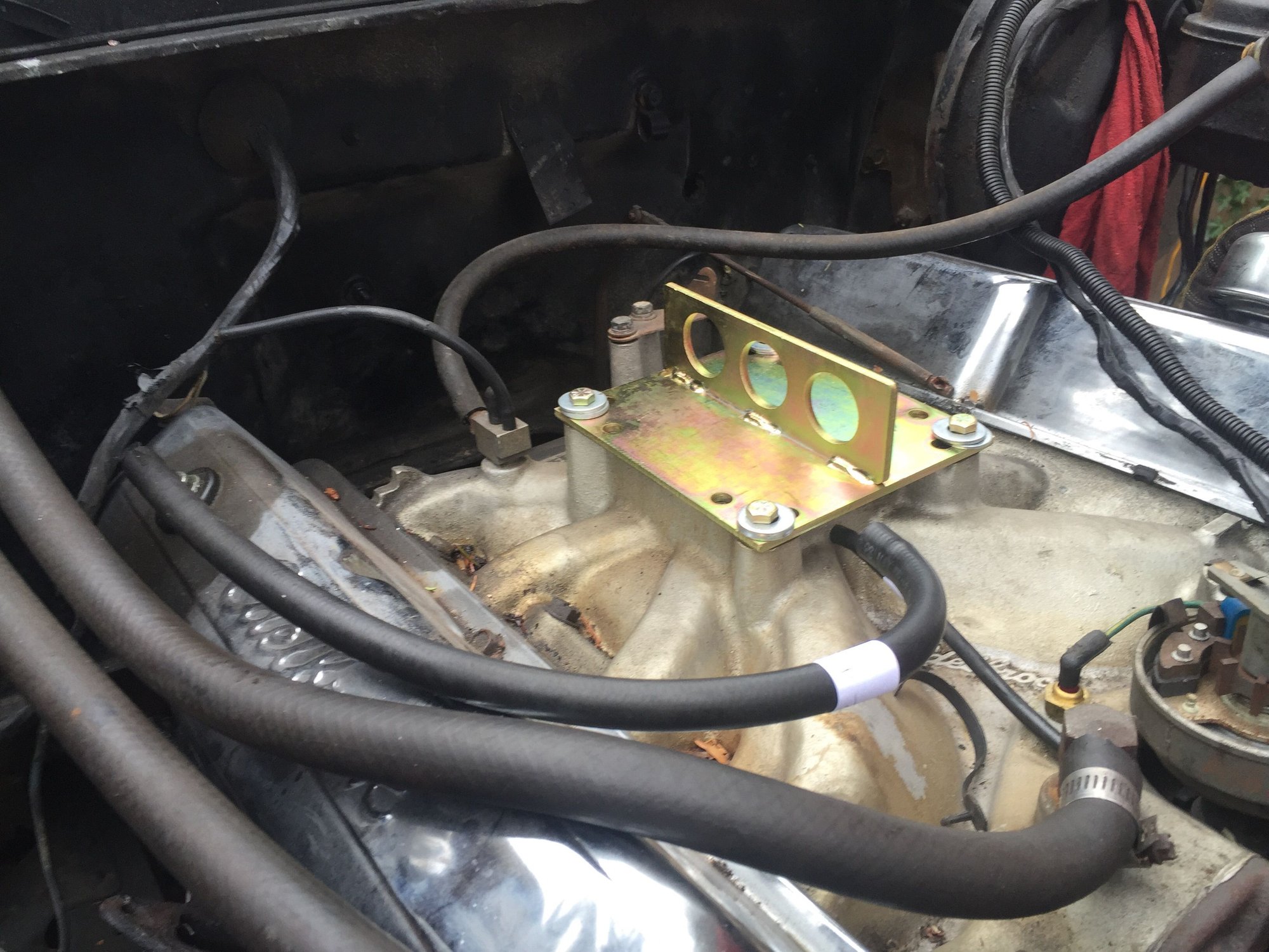

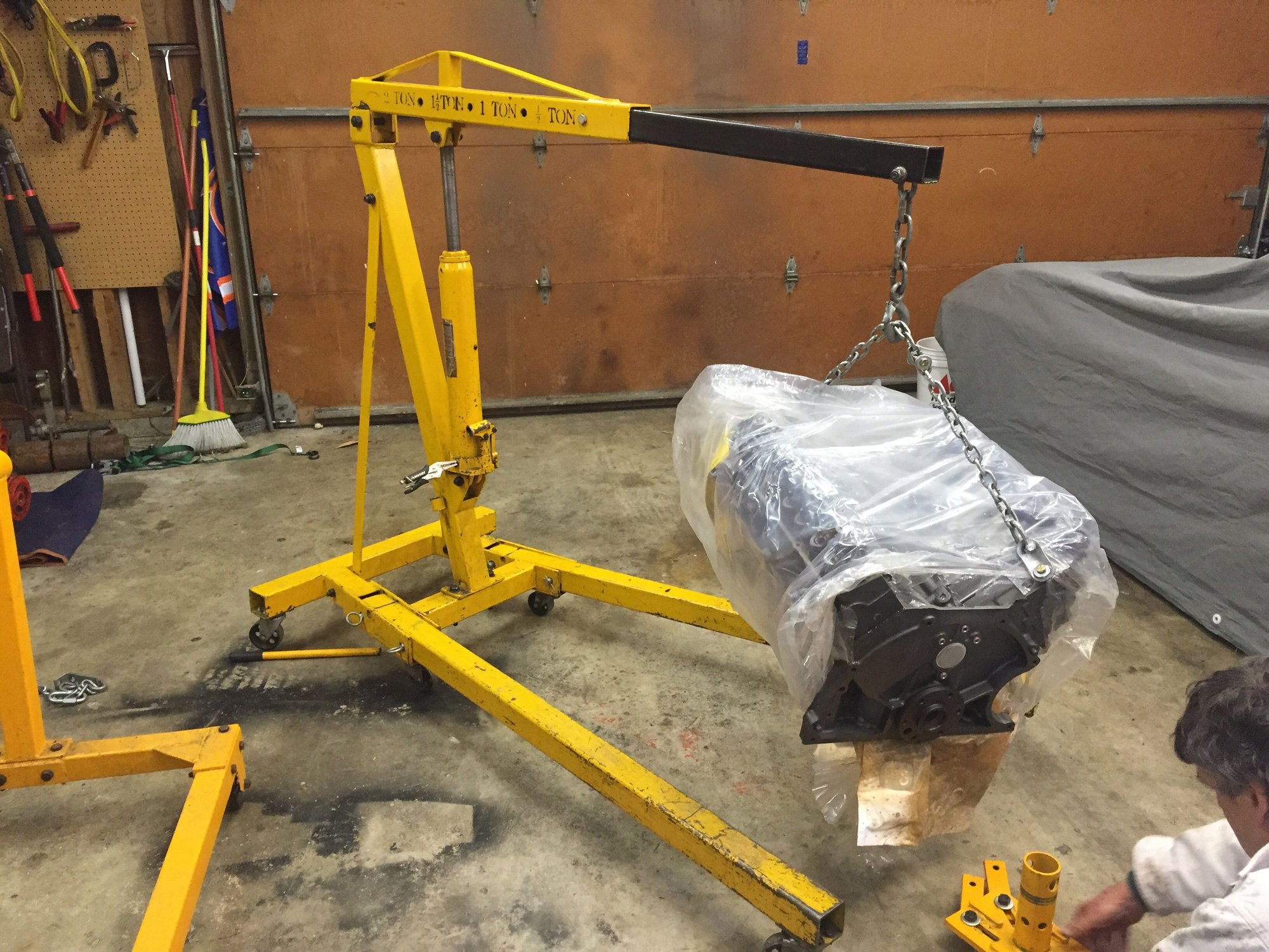

Right now the motor is hanging on an engine crane because the mounts on my engine stand are not wide enough to fit the back of the motor so I am fabricating some new ones.

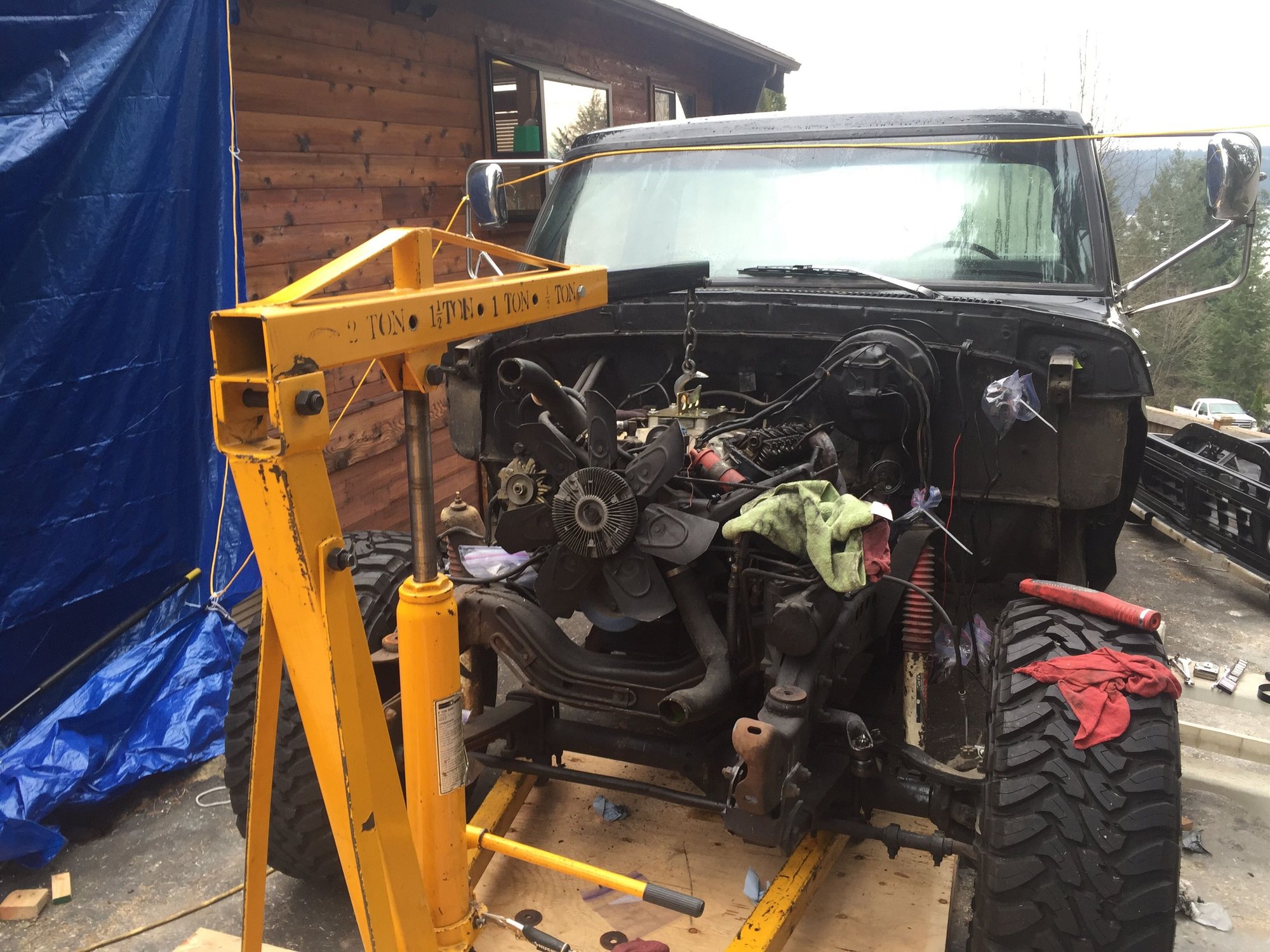

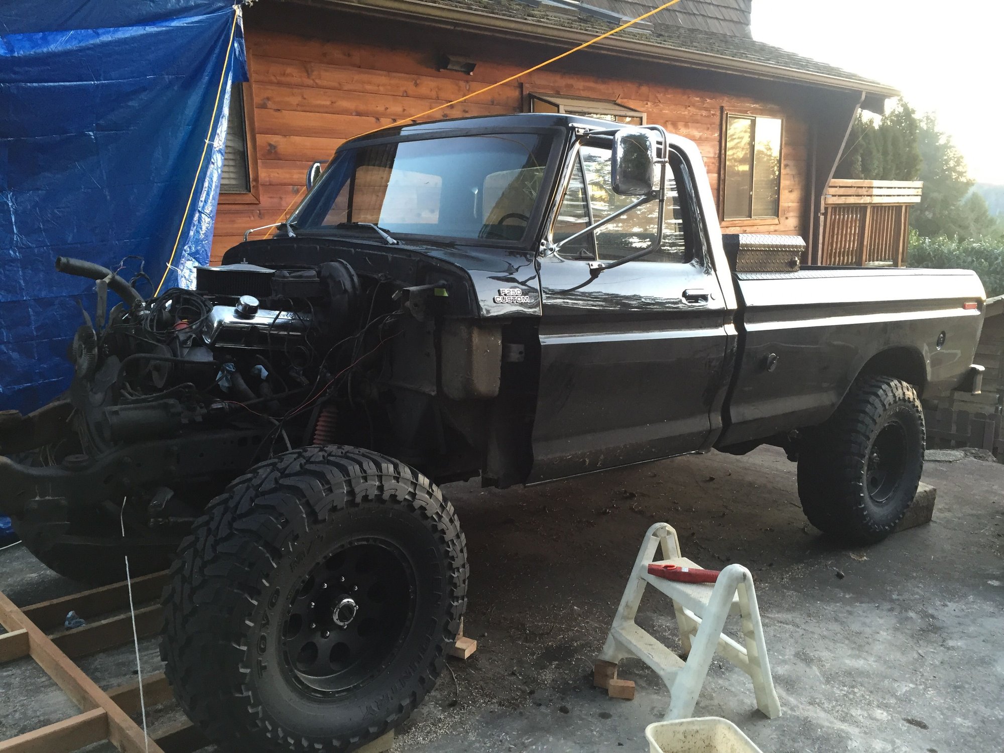

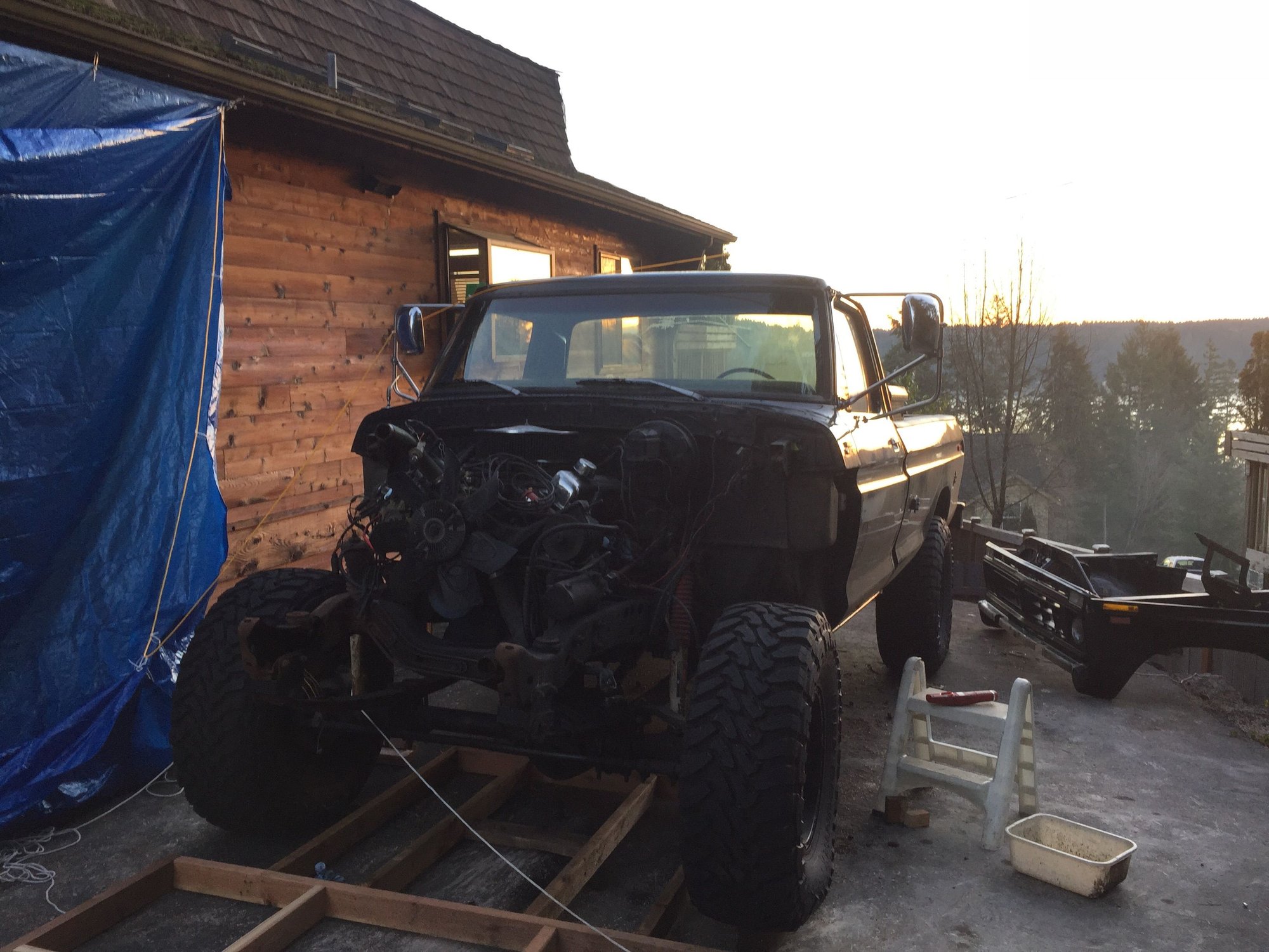

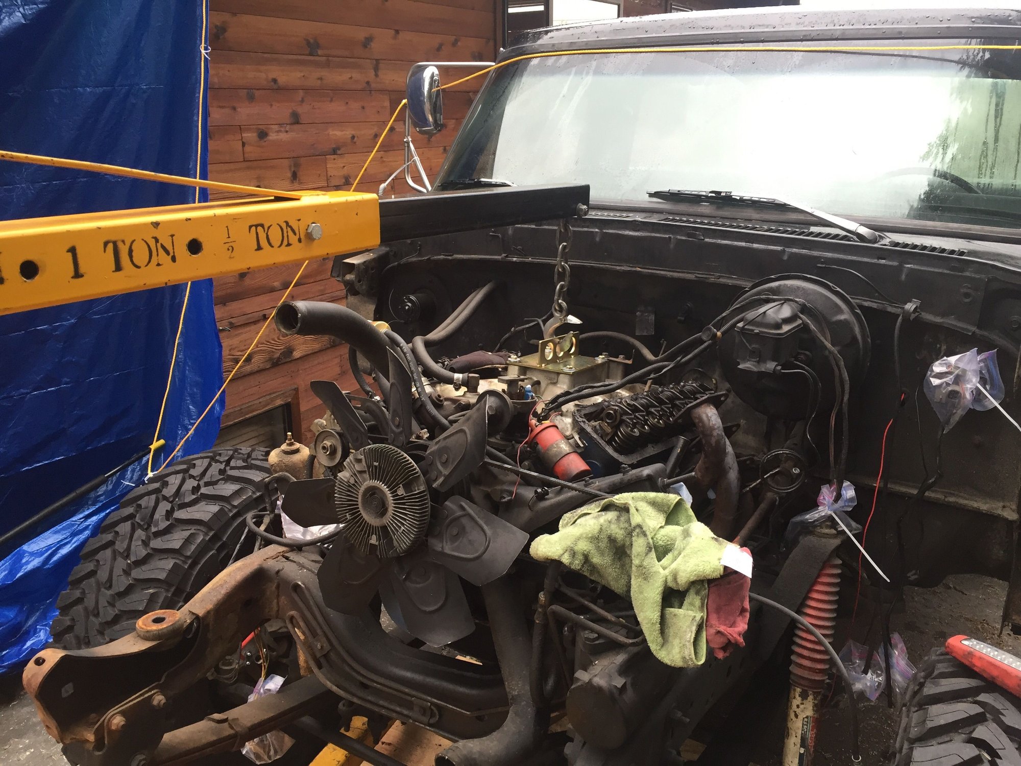

Yesterday my dad and I pulled the entire front clip off of the truck and it is now sitting waiting for the old motor to be pulled out. Which if all goes to plan will be tomorrow morning before work.
The wooden structure underneath the truck is there to both raise the engine crane up high enough that the motor can be removed easily and to level it out.

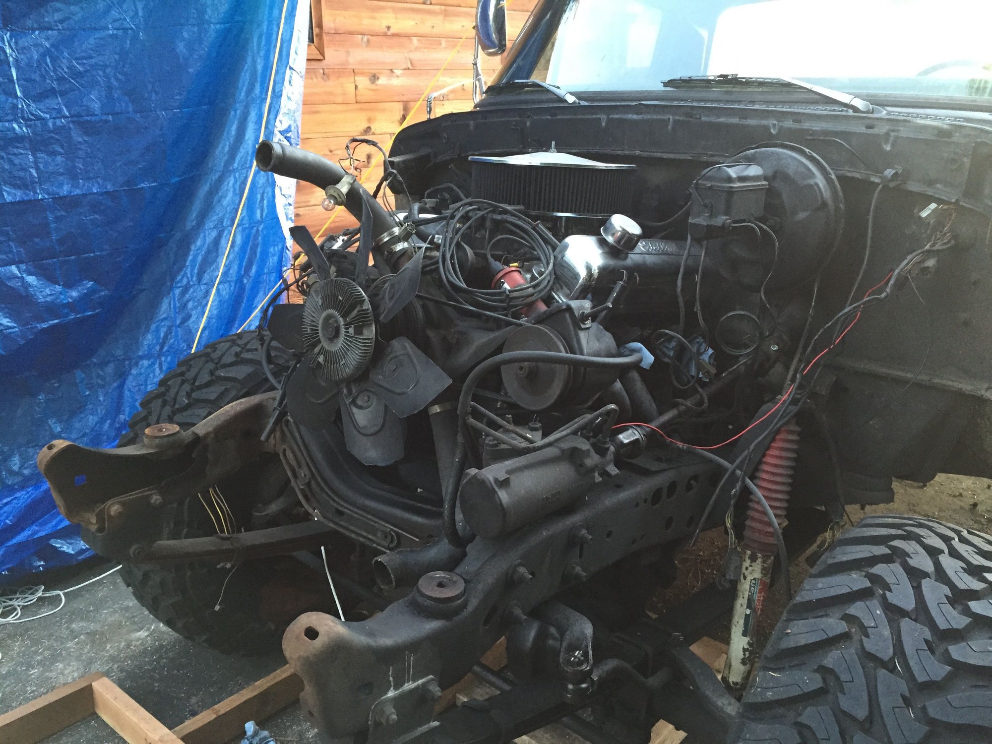

The motor is coming out today. Got the Engine crane hooked up to the motor and ready to pull, but I ran out of time and had to get to work so my dad is going to finish pulling the motor
