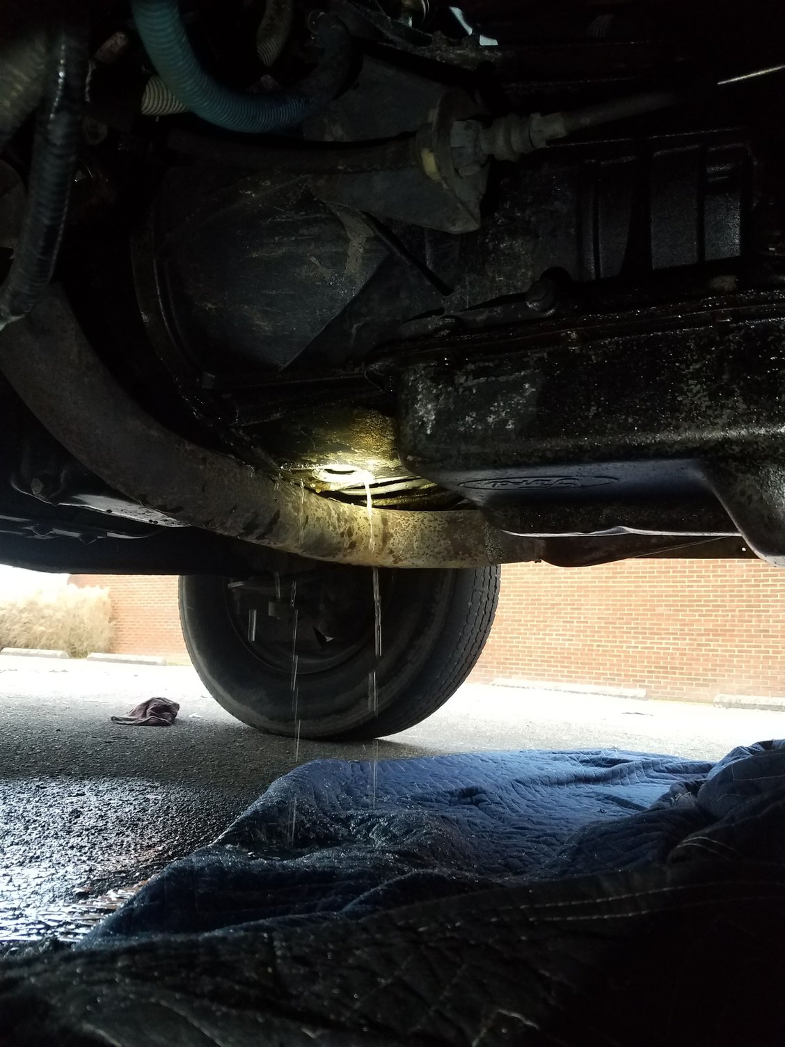

Old Dec 19, 2018 | 05:48 PM
Petey Selekta's Avatar
Petey Selekta
Joined: Sep 2014
Posts: 3
Have the same problem. Can someone help. Photo posted below
