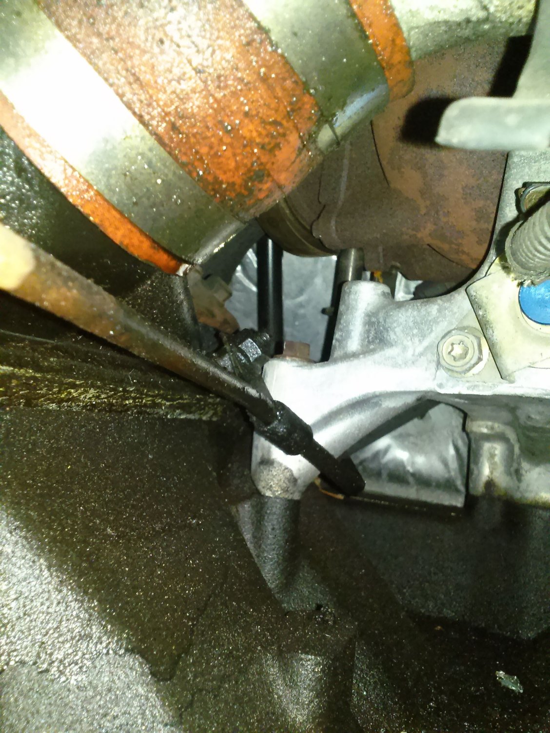

Here's a photo of that clamp. I don't know if the wet is from the fuel line or the intake.
I think that if it was the fuel line in the photo that you would get fuel in the valley and down the passenger rear of the block. It might be dripping out where the transmission meets the motor.

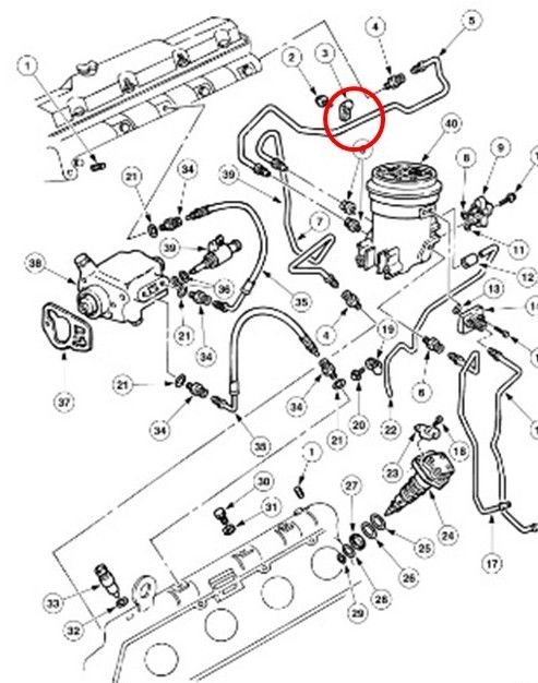

Fuel Line Clamp (Often a Leak Spot)

Stumbled across this:
from here:
https://www.ford-trucks.com/forums/1...l#post14961317
