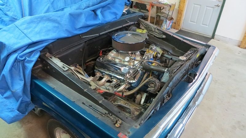

I built the engine over the winter of 2007-08, and it's got maybe 5000 miles since then. It runs great but the engine compartment is starting to get a little funky. Paint is peeling/ cracking. Road grime every where. I figured this winter would be a good time to pull the engine, clean it up, re-paint it and put it back. I'll also clean up and re-paint the whole engine bay. Hopefully, I don't get a case of the "might as wells" while I've got it apart!
I'm happy to see the American economy is recovering, but now the Canadian$ loses value to the US$. So, buying new parts costs A LOT more than it did a year ago! Here's a couple pictures. I'll post more when I've got it all apart.
Hood off, ready to get started.

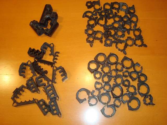

Btw, if you have or are thinking of convoluted tubing, 90s GM products use the clips pictured below to terminate the ends securely. They are waaaay better than using electrical tape because over time they unravel due to engine compartment heat cycles. They also use the pictured plug wire clips.
