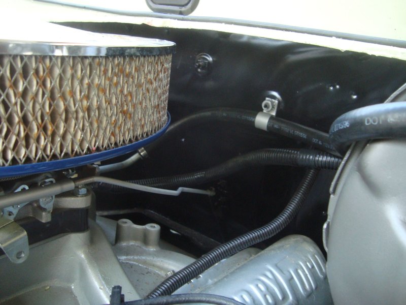

Per Murc's request. Pardon the dust and grit... I had left the hood cracked and then it rained like a horse pissin' on a flat rock. :

Thanks! Even the text printed on the hoses read left to right. Meaning, the printing can be read from the around the engine bay... well, except for the upper radiator hose but it's still in good condition so I let it be. Hose clamp positions, heater hose striping, and zip-tie directions are all consistent.
I got kinda **** about it all.

Thanks for the pictures, they're perfect. Very nice engine bay!
I noticed you have your brake distribution block on a bracket at the brake booster. I wanted to do exactly that. Where did you get that bracket and distribution block?

Thanks.. I swapped to '78 front discs and ditched the troublesome proportioning valve/dist. block from the donor and went with an adjustable Wilwood unit (about $80). I fabricated that bracket last year and Wilwood has since come out with their own bracket for about $35.... great timing Wilwood! However, my MC outputs on the engine-side... the Wilwood bracket put it outboard so I don't think it would have worked out for me anyway. Btw, it has its own brake switch so I'll be running a pigtail from under the dash to the switch.
And as far as the battery, yeah it would clean up the engine bay if it were relocated. Mostly following the K.I.S.S. principle, it's staying right where it is.
CarCraft mag a few years ago did an article on engine compartment design/detailing. They mentioned in that particular article sticking to four colors... engine color, black, silver, and polished bits. The focus is the engine so things like the booster and MC should take a back seat to everything else. Some guys will shoot them blue or have them chromed.... personally, I'd rather not call attention to those things. Same goes for wiring looms and wraps.. keep'em black. Ever see an engine use colored wraps? It is really distracting. Oh well.. to each their own.
