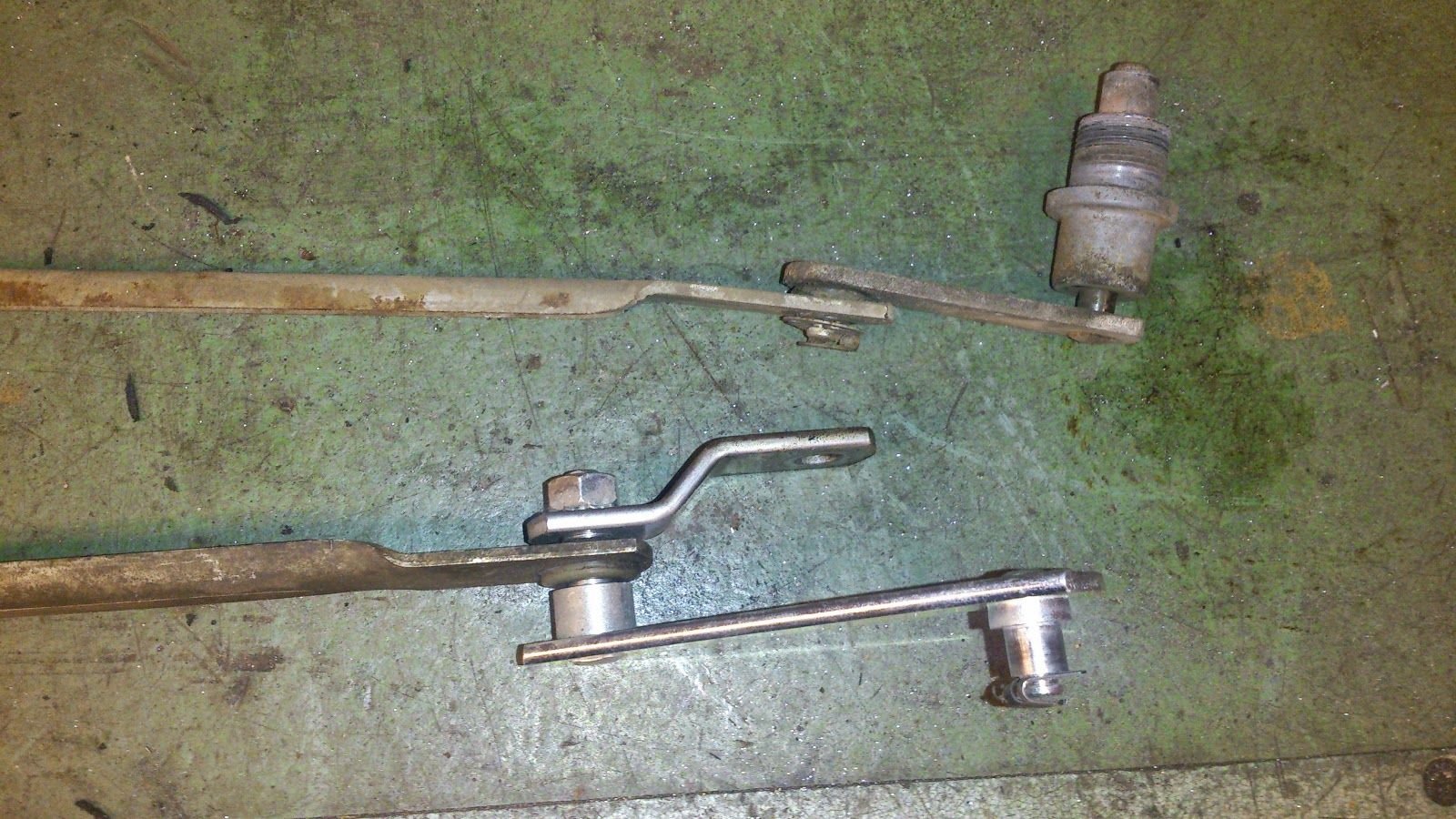

jimcar thanks. That might be what went on a factory electric wiper motor. The factory elect motor must have went round and round. The vacuum motor, and my electric replacement went/go back and forth.I do not have an original vacuum motor.Her is what I have.
Check out these pics.In the first pic is what my "replacement" motor has on it now. In the second pic is what I believe the original one looked like. What is in the pic is drawn on paper with a sharpie.I need to know the measurement from the center to the pivot point on each end and the correct angle of the "bend". I might make a new crossbar out of a round disc about 3" in diameter. The first hole will be easy to place , then I can guess at the second hole and redrill a couple of times if necessary. Thanks all.

I now have working wipers on my '56. Since I didn't have the part to fit on the motor shaft, for the wiper linkage to hook to, I had to figure it out myself. I started with a round metal disc, about 4 inches in diameter. With the motor and disc mounted I moved the wiper arms to the end of their travel and marked the disc where they needed to be attached. I'm pleased with the results except the passenger side has a little less travel than the driver side.
