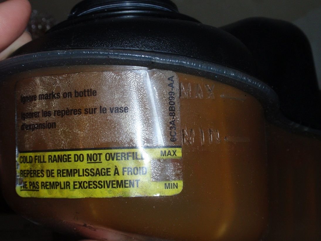

hey guys i have a 2005 f250 superduty with the 6.0. about a month ago i blew a head gasket and spent about 5 grand getting them fixed and stuff replaced like the waterpump, resevoir thermostat and also had the arp head studs put in. i am also new to the diesel trucks so i might be over reacting but i have ran the truck for about a month now with no problem. i notced that they filled it up above the max but today i just happend to pop the hood after sitting in traffic fr 2 hours and noticed it was just below the max line instead of just above it. should i be worried?

If it was just filled up, you don't have anything to worry about. After the first time or two you drive it, it will need to be topped off to max (cold) as air gets purged out of the system. Beyond that, it should not be changing.
If by "reservoir" you mean the upper coolant bottle, you'll typically see it referred to as the degas bottle on this forum... Because that's where air (gas) is removed from the coolant, I suppose. How is yours marked? There is an old style with two lines that ford added a sticker to, and the new one with one line and a sticker.
The old one is the brown discolored one... The nice clear one is the new one I got a few weeks ago.

I will add that you shouldn't fill the bottle any higher than the min. line and a new Ford t-stat is the way to go. They have redesigned them. My 05 could vary the amount in the bottle by as much as 1/2 inch and then be back where I had it the next day. The 6.0 cooling system can play with your mind. Don't let it. Just check when fueling and enjoy the truck.
