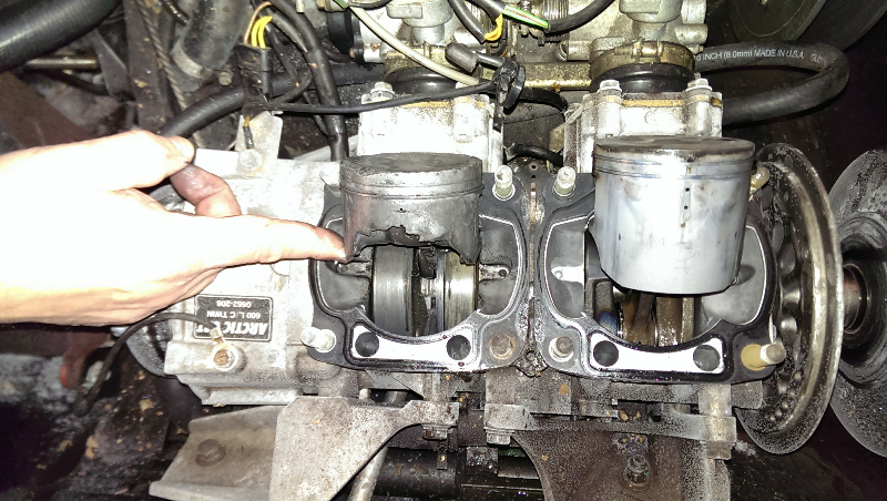

There was no hole in the piston. There is a hole in the crankcase though. The mag side piston dropped it's skirts
Sent from my Telegraph using IB AutoGroup

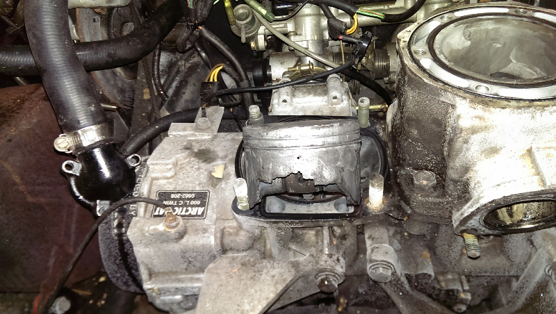

Oops.

Good evening guys.
That's some good carnage there Chris.
Looks like a meltdown and then the skirts broke.
Torn boot, plugged jet, bad crank seal.....

Boots looked fine. I think this has been having issues since before I bought the sled. Lots of damage on that piston

Originally Posted by Ford79
Good evening guys.
Torn boot, plugged jet, bad crank seal, owner abuse.....
Fixed

Originally Posted by MisterCMK
Oops.
Attachment 111873
Attachment 111874
Must be why you kept the 500
