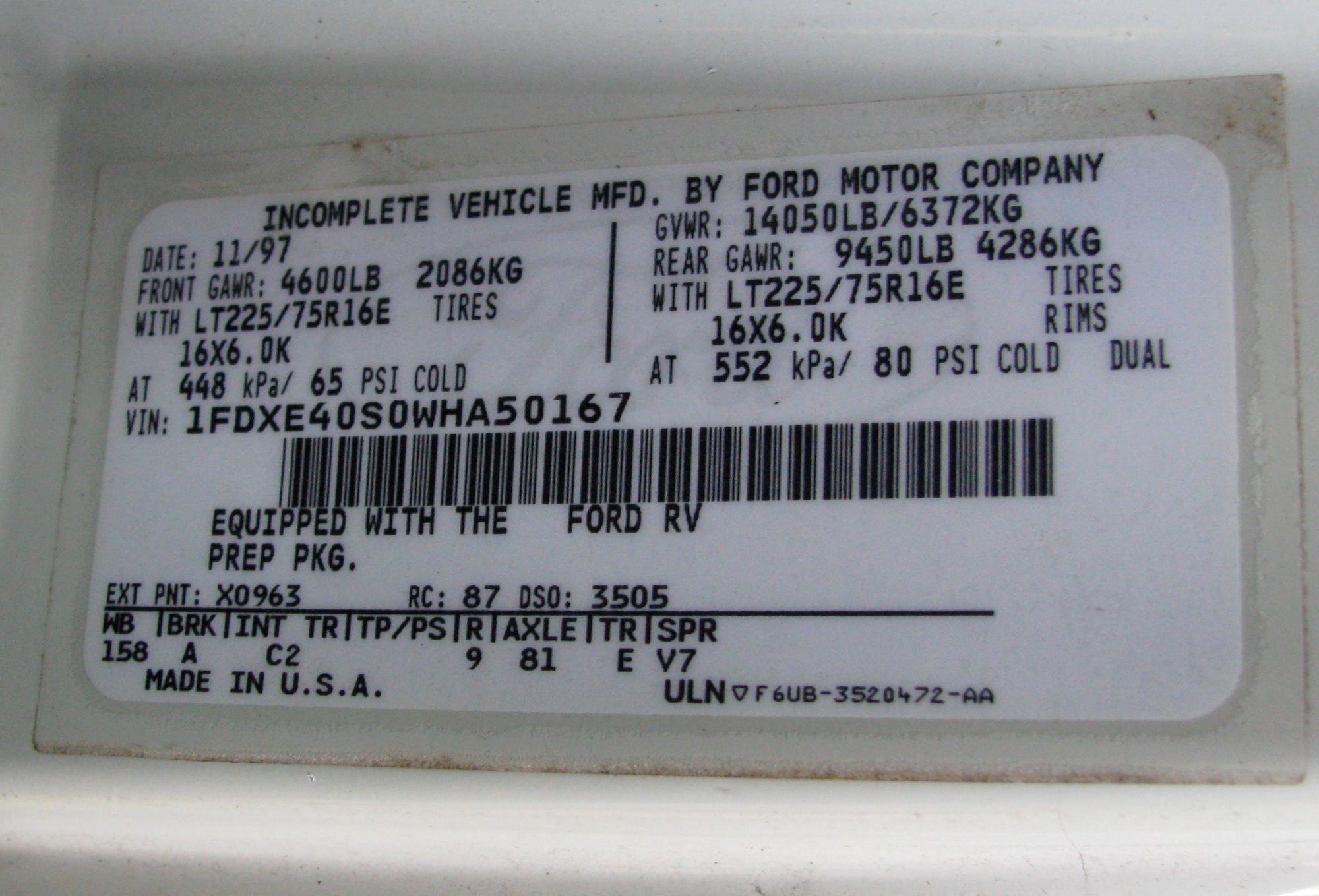

I just bought another Ford E-Series the other day. I bought a 1998 Ford E-SuperDuty (Fleetwood Tioga Motorhome) with 81,000 miles for $2500. The cab/chassis and 6.8L V10 are perfect but the RV part is junk due to a damaged and leaking roof. It does have a nice Onan Microlite generator.
My question is about the cab/chassis. I am used to seeing E350 and E450 on the cutaways but never noticed one just labeled "E-SuperDuty".
Trying to find out more info. Is it equal to an E350 or E450? I'm sure this is a stupid question but I am not having any luck finding out any specs on this cab/chassis and would love to know what I have before I begin tearing off the RV and adding a sleeper and flatbed.

what is the vehicles gross weight rating?

i also just found some info that suggests that the axle code 81 means Dana 80 with 4.63 gearing on the vans.so to go along with the gross weight rating,the axle is also suggesting the platform would be the f450/e450.

The GVWR on my 1998 E-SuperDuty is 14,050-Lbs.

from fleet ford:
VIN: 1FDXE40S0WHA50167
VIN Code:1FD Assembly Country:United States
Make:Ford
Body Style:Motor Home
VIN Code:X
Restraint: dual Front Air Bag/Active Belts
GVWR Range:14,001 - 16,000 Pounds
VIN Code:E40
Vehicle Line:E-Super Duty Vehicle
Type:Truck
VIN Code:S
Engine:6.8 L
Cylinders:10
Fuel:Gasoline
Engine Manufacturer-FORD VIN Code:W
Model Year:1998
Assembly Plant - VIN Code:H Assembly Plant:LORAIN, OHIO
Production Sequence Number - VIN Code:A50167
Prod Sequence NumberA50167
so according to ford, this E-40 RV chassis is in between the E-350, and the E-450.

Finally got some more info from Ford.
They confirmed the E-Super Duty to be the exact same vehicle as the early E450.
14,050-Lb GVWR
20,000-Lb GCWR
10,000-Lb Max Trailer Weight
I weighed the motorhome a few months ago with all holding tanks empty, half tank of fuel, and only me onboard. It weighed in at 12,520-Lbs. I have since completely removed the motorhome structure as well as the rear frame extensions. It is now as close as I could get it to the way it left the Ford plant as a cutaway cab/chassis. Only the roughly 48" mid-section frame stretch remains. I reweighed the vehicle a few hours ago and it came in at 5,880-Lbs. Again with the same fuel level and only myself onboard. Now its time for the rebuild. I am installing a 72" mid-roof double bunk sleeper cab and a 16'x8' flatbed.
