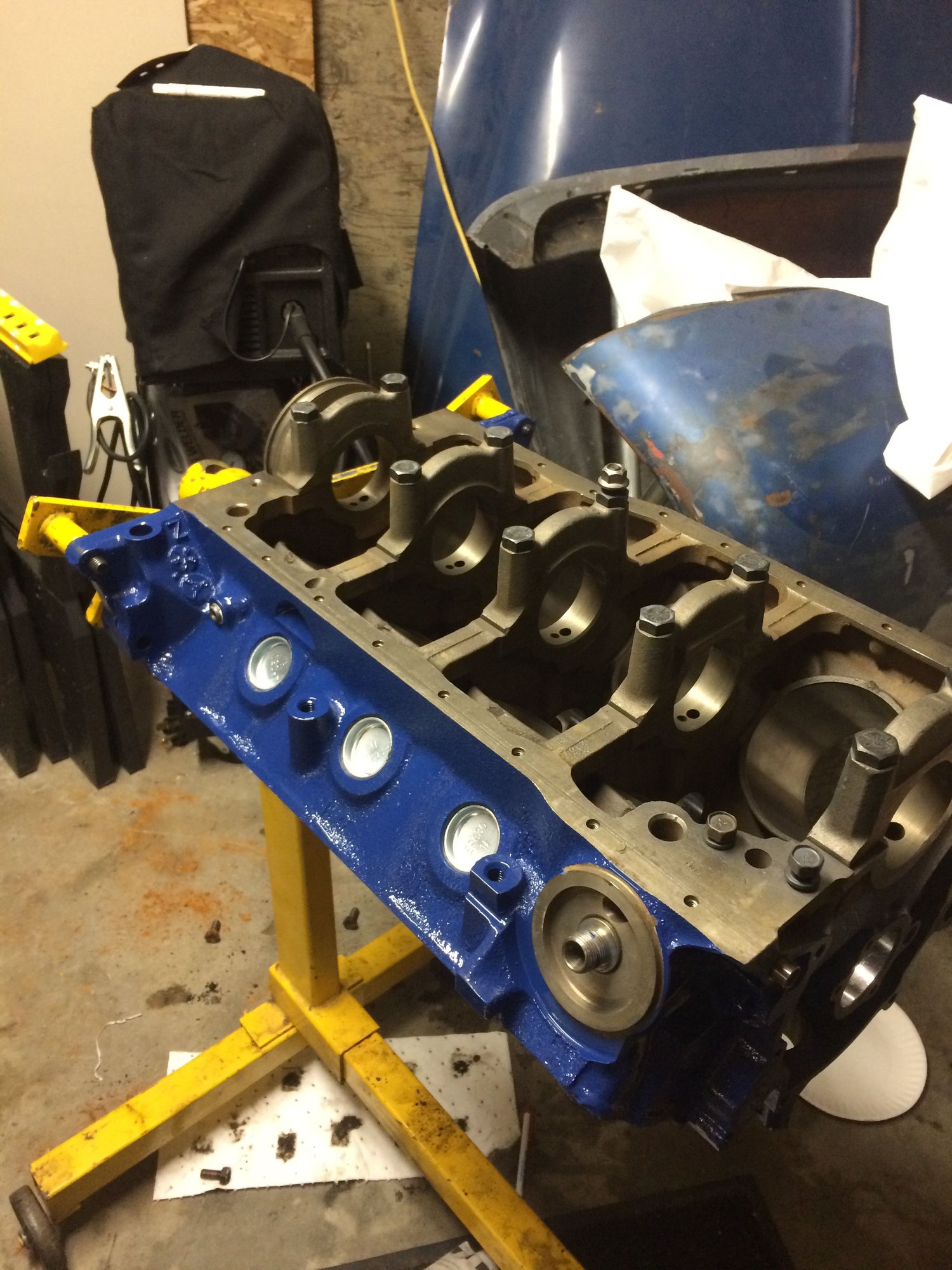

Old Jan 10, 2015 | 10:08 PM
  #54
cruiser456's Avatar
cruiser456
Joined: Aug 2013
Posts: 88
From: Columbia River Gorge
Got my transmission back from the rebuilder and engine block back from being hot tanked and cam bearings installed.Got it painted yesterday and slowly starting to get it back together.Got a bunch of parts ordered and should be here next week.
Old Jan 11, 2015 | 08:10 AM
  #55
gas6999's Avatar
gas6999
Joined: Nov 2013
Posts: 50
engine
your project looks like its going well, did you have the block board, or honed at the machine shop? make sure you put the cross hatch pattern back in the boars so the rings can seat,, you will need to check the rod and main clearance, also the ring gap, don't ever just assume the clearance is right, I have seen + and - bearings right from ford, which means the crank was a little small or large from the factory, I have had standard rings that I have had to file to get the proper clearance, check all clearances, another thing with a small block, make sure the dorman plugs in the oil galley are staked, if you blow one of these out its all over,,, good luck George.
Old Jan 12, 2015 | 01:01 PM
  #56
cruiser456's Avatar
cruiser456
Joined: Aug 2013
Posts: 88
Thanks George. Just had it honed.Plan on checking the ring gap etc..
