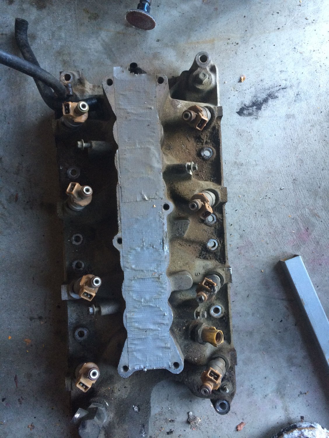

What does the intake look like? Do you have a picture?
Here is the intake a dug some other stuff out to.
On second thought, the outside of the motor shows many years of crud. Maybe it is time for a rebuild.
Yea.Made my mind up that i'm going to rebuild the lower end.Any way to determine what this engine came out of? Local Ford shop though 87 T-Bird.Thoughts anyone?

Dude you SCORED!
That is the High Output engine out of a mustang. Has the good heads, sequential injection and all.
Time for you to start reading up on it. I would join up over at thecorral (mustang forum)!
Good luck! Awesome find! If all the block numbers and stuff are right, that thing may be worth some money to those guys.
