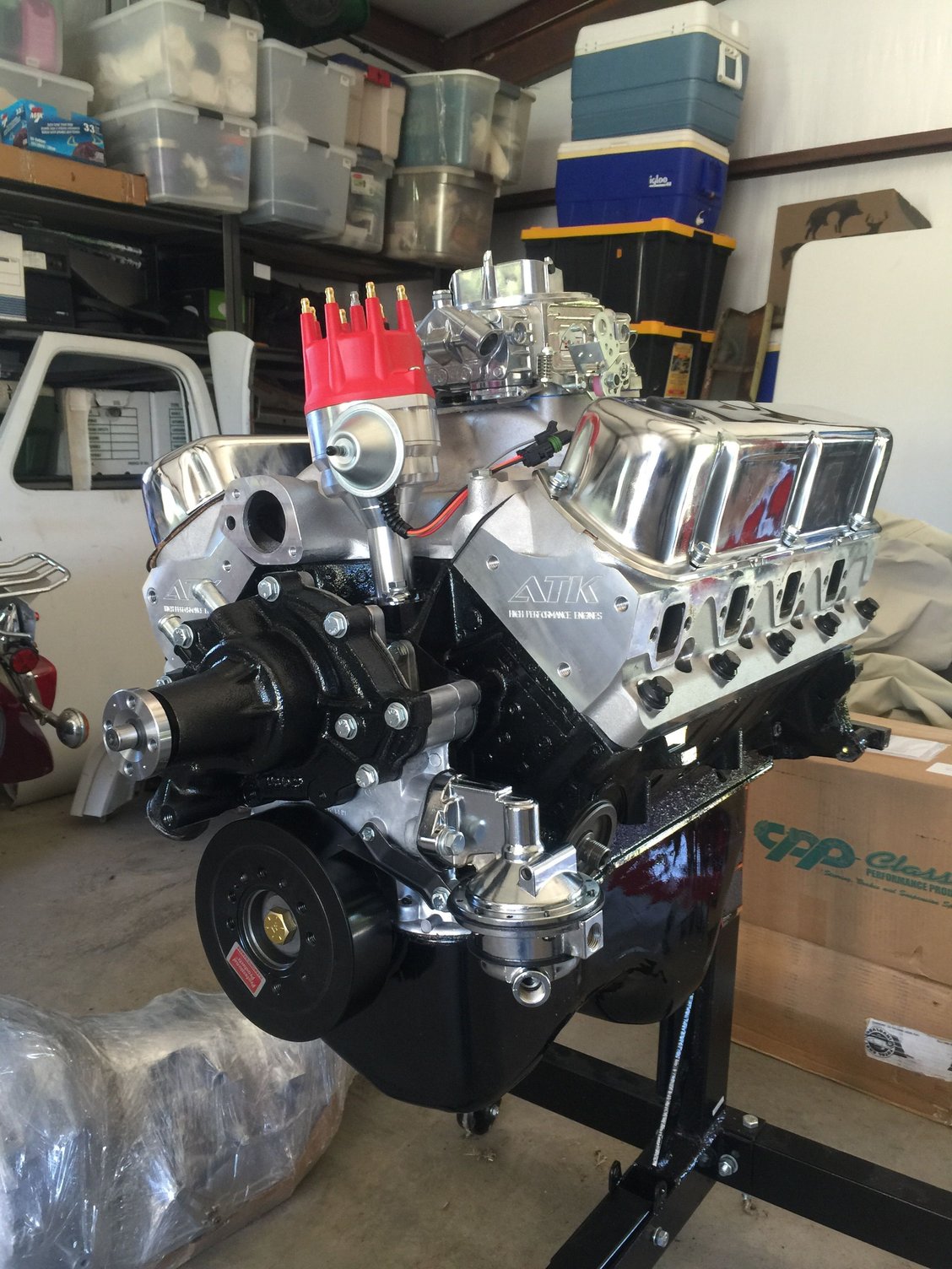

Motor came in .....
Just got the motor and transmission in ...... 351W 400hp and 410 torque.
Where did you purchase this combo , any links?

HI 54 Project, '
We bought a 351W short block & had our engine built with an Edelbrock Top End kit from Summit -
Same HP & Torque. It's a lot of engine for these old trucks.
If you are having some help with your engine - make sure they include case hardened push rods.
Our Edelbrock package ate our non-hardened rods within the first 1,000 miles...
Looks like fun up there in Burleson!
Ben in Austin

Engine and trans
56 Panel- I had the combo built by ATK. I was really surprised at the cost and the warranty. 2 years on both !! They do have a site. Just google ATK.

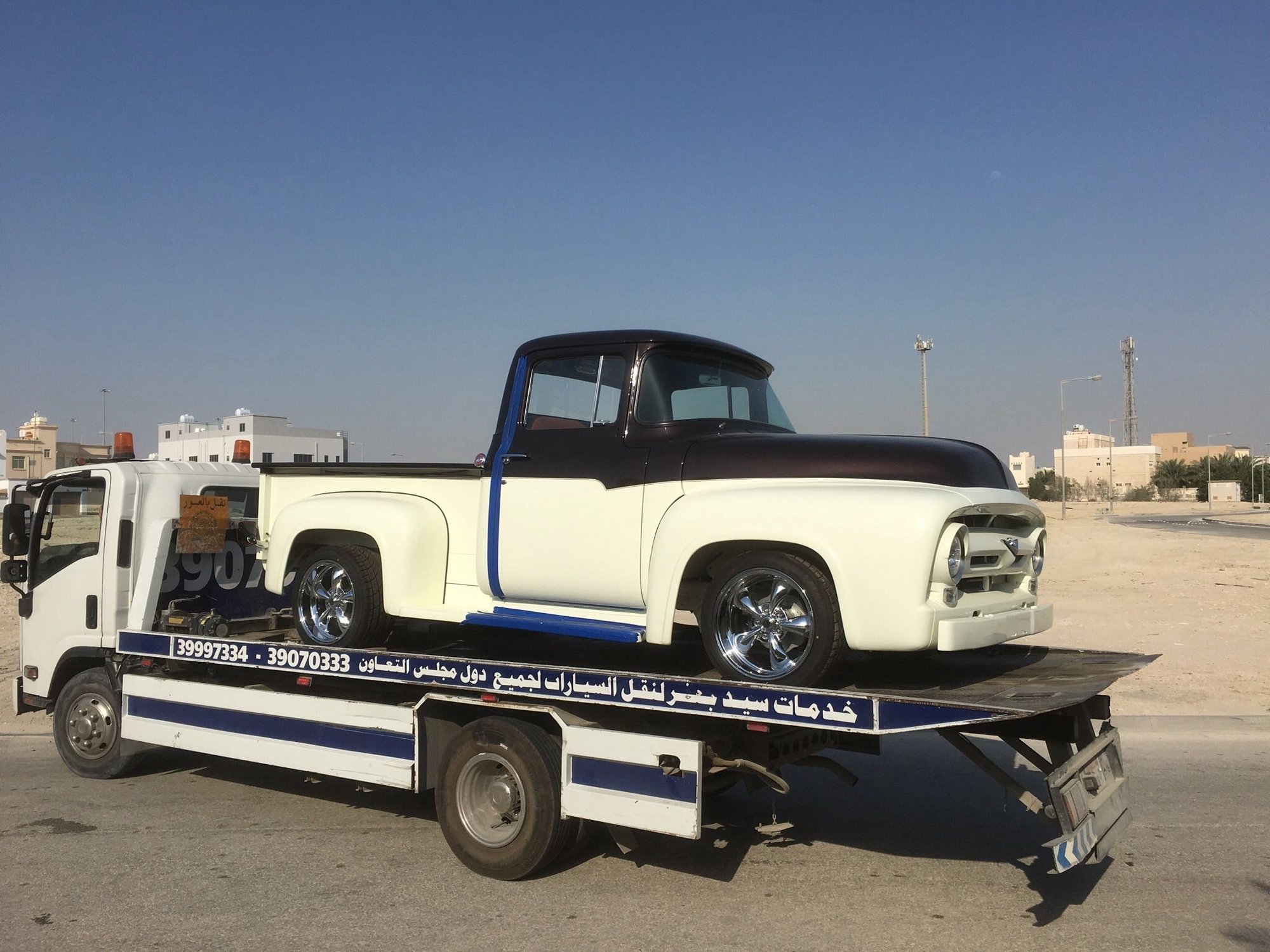

this is my truck now on its way to the exshuast shop
