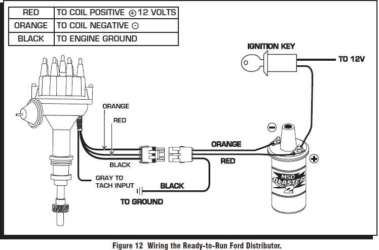

I have just tried to install a new MSD Ready to Run Distributor and Blaster2 Coil. I have it at TDC. I have the plug wires in order and I installed the distributor and rotor directly facing number 1 plug. I followed the wiring diagram and ran the three wire where it said. Orange negcoil, redpositivecoil, blackground. I also hood the factory wires from the old coil back to the blaster. I can't get this thing running. I'm lost. It seemed to want to try and idle briefly before I gave up on it. Anyone have a detailed guide to install my particular distributor in a 76F150? Or possibly any advice.

Why would you hook the old wires up? You need to first make sure you remove the resistor wire and make sure you are feeding the new coil with 12v power and not 9v like was stock.

I didn't know what the old coil wires were used for. Is it okay to feed 12v from the battey directly to the positive terminal on the coil?

For test starting? Sure. But you need the 12v on a keyed ignition source.

I gave the schematic above, he is not using a MSD box.

Thanks for the tip on the 12v lead. It helped a ton. Here's my new ignition setup.
