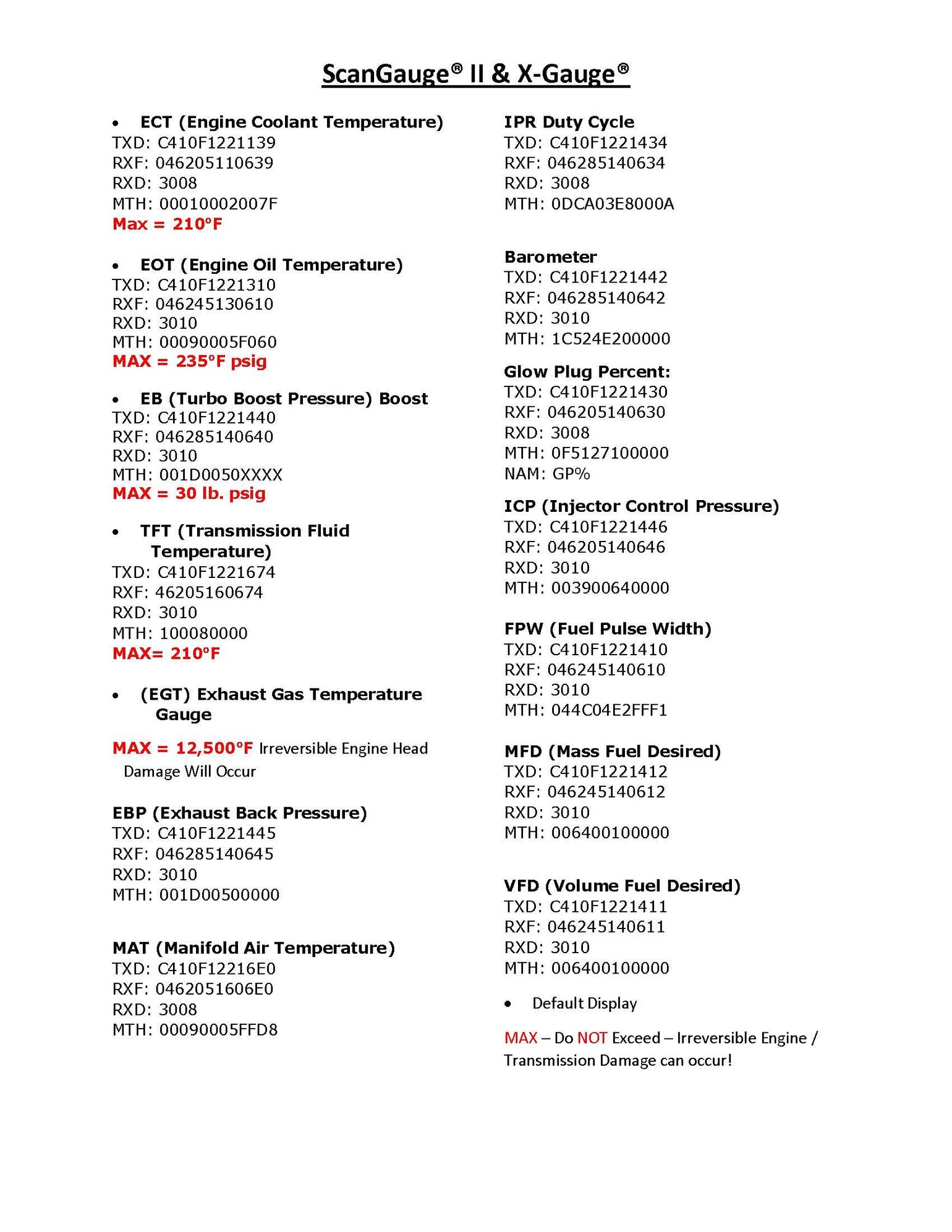

I've been running the Scangage II for a long time now and I have hit a snag. Where do you find the inputs for the MAP readings? I have looked all over the place and just cannot seem to find them, I don't know where I got them in the first place.

Ok I just went out and looked at my SG2. Pretty sure Map was pre programmed from factory.
Went under edit X Guage and map was not in my list.
That tells me I didnt manual enter codes.

There is no Engine Coolant Temp on our automatic Powerstrokes, and 12,500 degrees sounds a bit high for EGTs. I would think the fender would glow red.
12,500* would probably set the whole truck into flames TYPO! (think of the fuel and combustion possibilities - that Joker would smoke - literally )
1,250 * is the maximum.
On the 99.5 forward, the ECT becomes active after the EOT reaches 138* - 141* (Up until then it just reads 250*). Then it reads correctly.

With respect - I'm sorry, that's not how it works for my 2000 automatic truck. I have yet to see that gauge read accurately, and I've confirmed with an IR thermometer and a laser thermometer. If one were to go by that gauge, they would likely be stopping on the side of the road with nothing wrong. The sensor is not on the OBDII port in any way (confirmed on all wiring diagrams for automatics)... ECT is a calculation from a combination of other sensors. The ECT sensor is wired directly to the gauge on your dash, unless you have a manual transmission. As for manuals, members have reported the ECT reading on the OBDII port don't match up either, but I have no way to confirm that.

Thanks guys, I guess the MAP settings were already programmed into the Scangage when I got it. Believe me I think I have just about everything you can put in a Scangage in my X-gage settings. Is that ECT max of 210 correct? I see that a lot, even higher and that's after warm up as it's not correct till then. I also see a 14 to 15 degree delta on the EOT/ECT. I have always questioned my EOT, normal everyday operating I see 215 to 220. Towing it will max out at 228-230. Subtract the 15 degrees delta from that and you know what my ECT is showing.
