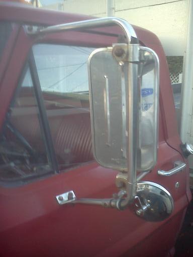

Originally Posted by Corkwheats
Well, they say a picture is worth 1,000 words.....Duuuuhhh on me! I thought the freakin' steady arm rest went towards the front of the door, and was wondering how in the heck I was gonna fasten it on there!
Those mirrors on your (beautiful) F350 are exactly like mine. The steady arm rest sets below the mirror.
Gosh, if there were any way you could get a picture of precisely where that steady arm bolts into the door, that would do me some good. And, if you can't, that's cool. I'll figure it out.
Also - are those the Ford Clamp on Convex Mirrors? Can you get a close up shot of exactly how you have them mounted? If so, I would join your fan club (but not stalk you).
This really helps. I'll be putting at least one side on tomorrow.
Thanks,
Bob

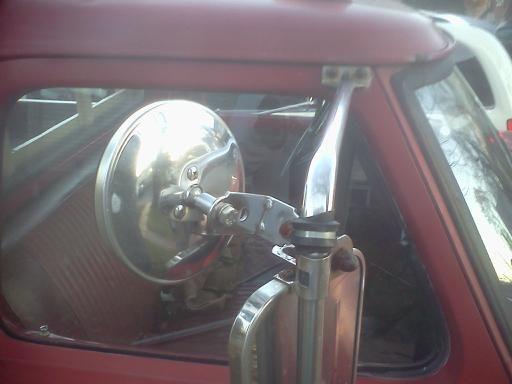

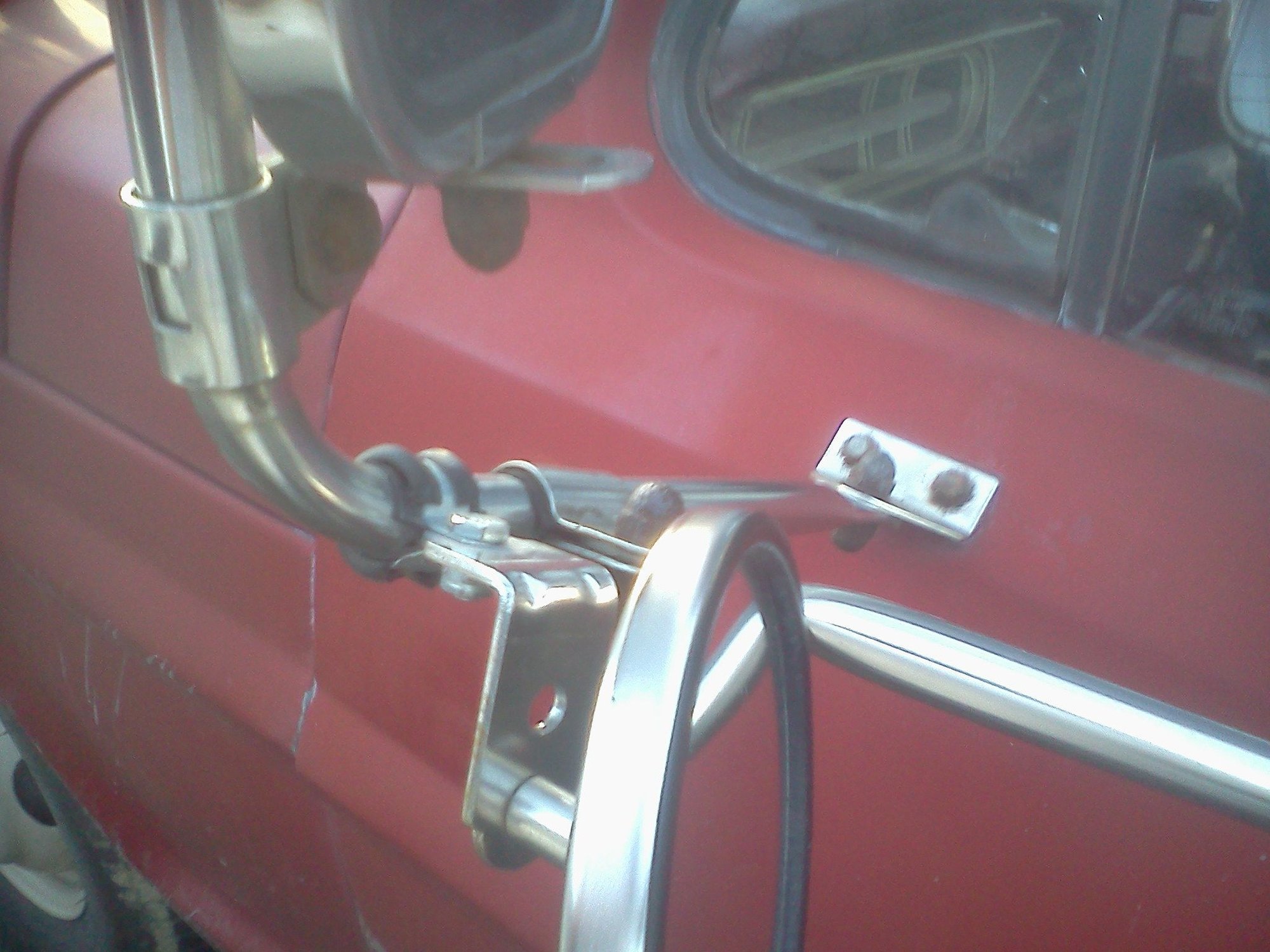

Here are the pictures you requested. The convex mirrors are just generic ones I bought at an auto parts store. I tried a stick on convex mirror but it covered to much of the mirror itself so I got the clamp on mirrors. I fastened them by getting a clamp at a hardware store. To keep the clamp from slipping I cut an old bike inner tube to hold it in place.
Thanks for not stalking me!

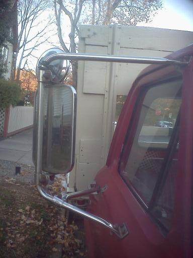

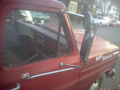

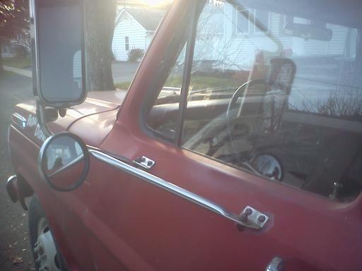

About the convex mirrors. you will notice I put the drivers side down low because it did create a blind spot. The passenger side is up high as it did not create a blind spot. Both convex mirrors are pointed down so I can see my rear wheels when I back up and they also show a wider view than the West coast mirrors.
here are the pictures:

It looks odd with steady arm mounted backwards on the door.
A first for everything tho.
