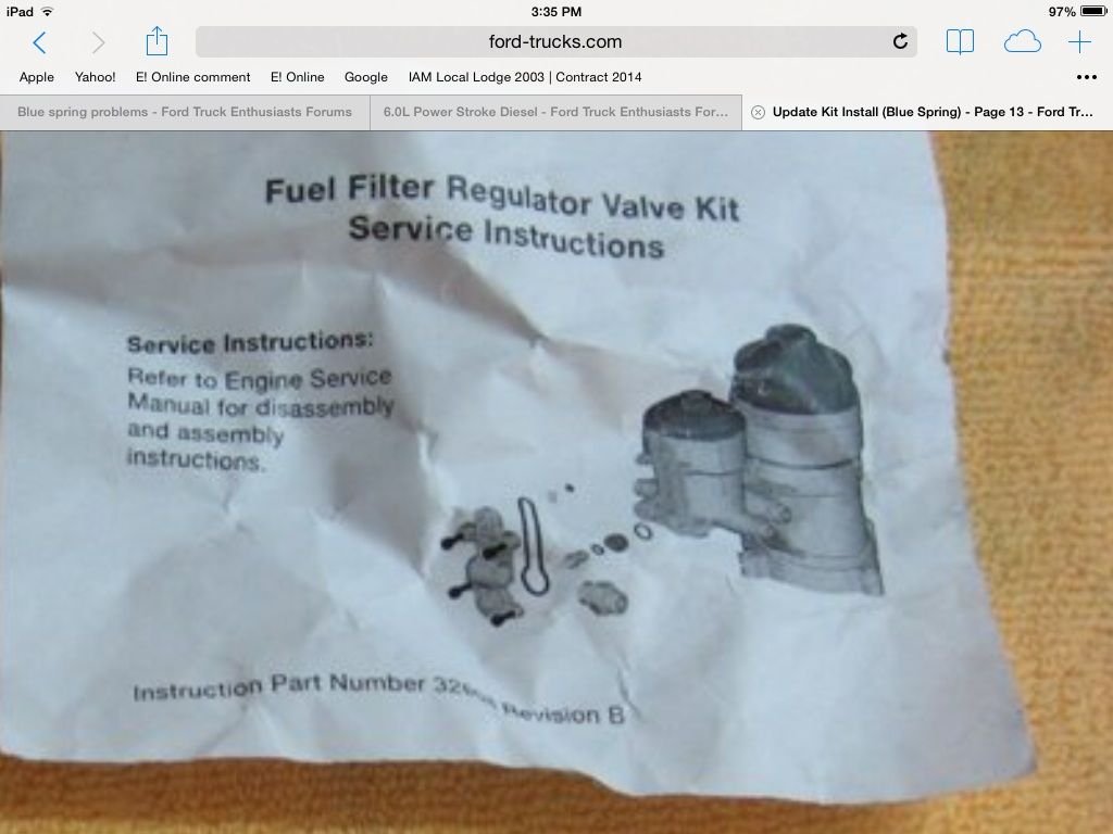

The best picture I could find quickly. As you can see ther is a o-ring BEHIND the black plastic cup if your regulator has a cup/bushing. Also, no pics but there are two styles of housing that use two styles of cup. One has an extra shoulder on the outside. Make sure they match (old/new). Leaving out the o-ring behind the cup has been reported to make a sound you can hear with the engine running.

when inside the fuel filter housing... you have access to the little plastic peice... if i were to remove the filter could i add the oring fromthere? or does the FPR have to come off? just wondering?
Old Dec 19, 2014 | 02:09 PM
mustang_309's Avatar
mustang_309
Joined: Dec 2004
Posts: 4,138
From: South Weber, Utah
You have to remove the fuel pressure regulator cover, look at the above post from Rusty, in the photo it shows the exploded view of the regulator.
