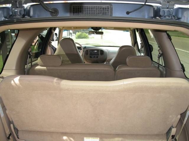

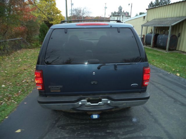

Oh and one more thing, The difference between Tinted and Privacy
I don't know why the hell ford did this, but you could get the clear glass of course (no power).
Or for the poor people that couldn't afford the Privacy option..lol Ford so kindly gave you the option of Factory power glass WITH Tint, I'm sure you've seen Expeditions with rear glass where you could see the dark outline of the glass even on the lift-gate. I forget the exact percentage, but you could still see into the vehicle up-close and it was more for sun-protection..
This is glass with integrated factory Tint:
And of course the Luxurious Privacy-tint option..lol
And the elusive clear window beast
