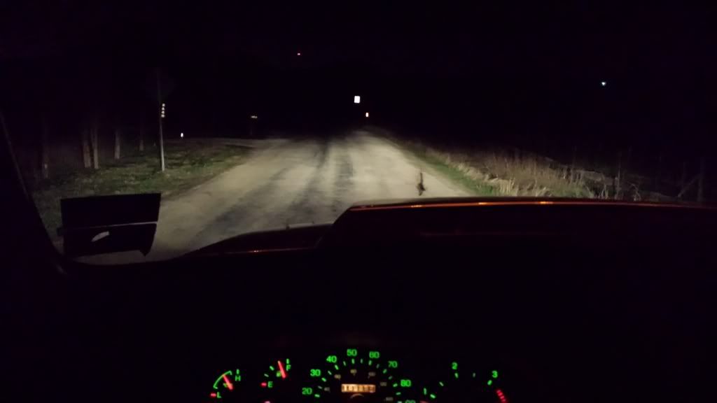

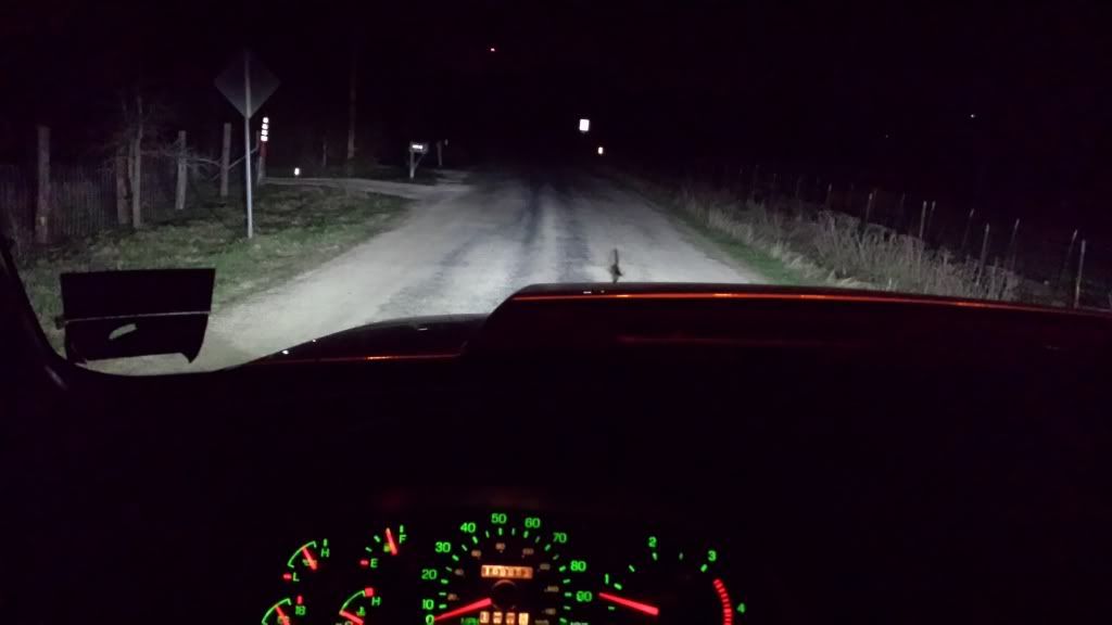

I'll throw out one more option you can try. LED headlight bulbs. I tried the following set in my SD. Very easy install and cheaper than HIDs. The problem that I had with them was that switching to high beam made zero difference in my Super Duty headlight housings. The OBS housing is slightly different, so they may work a little better in the OBS. If you don't use high beams very often or at all, the LED bulbs are the way to go. They shined the light in the same pattern as my halogens on low beams, just way brighter. I loved the LED bulbs and I would definitely run them if it weren't for the high beam issue. I use my high beams all the time, so halogens are actually shining farther than the LEDs were because I can use the high beams. If I wasn't using high beams, I'd run the LEDs and be happy with it. For what its worth, HID high beams suck also with out projectors.

Here's the comparison pictures between old halogens and LED bulbs in my SD. I put tape down on the road and parked on top of it for both pictures.
