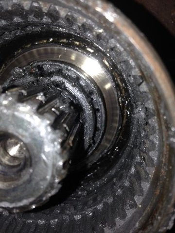

I have the hub apart and am to the point where I don't see how to get the hub off. Is there another snap ring at this point? I do not see it - where is it? Is there another way? Also, it looks like I need some hub parts. This outer part looks worn (is it a part i can get?) also, one of the washers is split. It was not dry, but the grease was tired
What cha think????

Based on the last photo, I may be wrong here but it looks like you're gonna need a locking hub nut removal socket for a Ford to get the two locking nuts off of the wheel bearings so that the hub can come off.
The tool looks like this:
Amazon.com: OTC 7158 Hub Locknut Socket Wrench: Automotive Amazon.com: OTC 7158 Hub Locknut Socket Wrench: Automotive
It can be picked up at any auto parts store in the tools section. They may even loan one but it's cheap so just buy it - for next time.
The outer nut locks the wheel bearings in place after adjustment. Under it is a ring with a series of evenly spaced holes around it that you use to lock the inner lock nut in place after the bearings are adjusted.
Someone can correct me but the adjustment is just to install the bearings and race if necessary and then the inner lock nut. Tighten the inner lock nut to remove any end play and make sure the hub rotates freely. It will probably be necessary to back off the inner lock nut slightly to allow the hole on the lock ring to line up with the pin on the inner lock nut. I don't remember the torque specs on this but they are probably available here on this site. The holey lock ring then slides in the slot on the hub and engages the pin on the inner lock nut to hold it in place. After the lock ring is in, you put the outer lock nut on and torque to 60-80 lb/ft I think. Then reassemble the rest of the hub.
Hope this helps.

I got it. It was removable with a pin. I got it apart, switched the rotors and pads and got it back together
