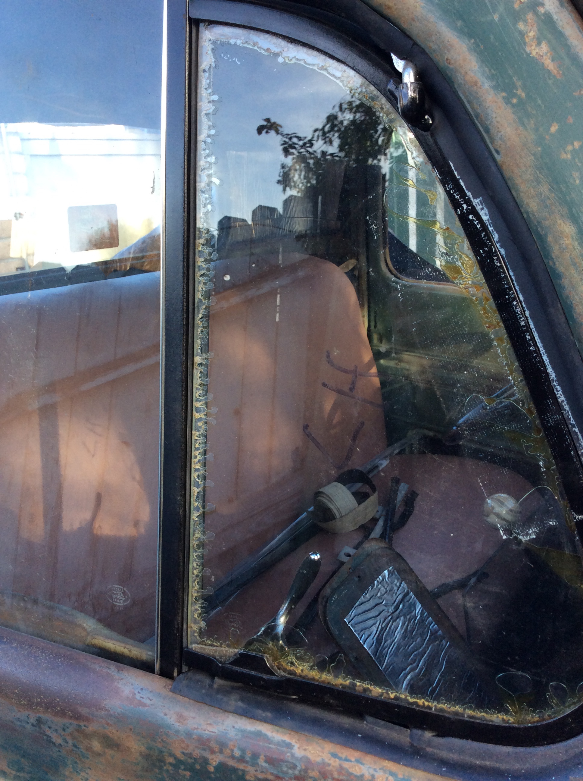

Size:  1.42 MBThe window kit arrived from Classic Parts Group. The parts were made by Dales Manufacturing (USA) (photo)::. welcome to dalesmfg.com .:: and were packed well. I began installing the top/side channel. I screwed this channel in with 1/2"-4 counter sunk screws as was the original. The division bar Channel fit well too, I painted these and will rivet the new Channel in tomorrow. The seal inbetween the channel and wind wing glass is to be riveted onto the bar. Not sure how well this will work. I may use 3M weather strip adhesive to augment the fasteners. The felt anti rattle strips seem to be formed correctly and have OEM style clips to install them. So far so good. As I post updates and update pictures I will store them in my album.
Update #1
I installed the division bar and test fitted the vent seal. (photo) I will glue in the vent seal. The vent needs to be adjusted in a bit on the top to close the seal. The anti rattle strips are formed well but the clips were another story. I will call tomorrow to get the mfg. ideas on how to crimp them on. It seems as though the clips are not wide enough and they distort when crimping over the wider strip.
Update #2
Still working on the felt strips. The clips aren't a perfect fit and take patients to get right. Dales sent me another set of clips free of charge but did not have any pearls of wisdom for installation. The block I made helps. Overall I'm happy with the kit, the components fit well.

Attachment 129860The window kit arrived from Classic Parts Group. The parts were made by Dales Manufacturing (USA) (photo)::. welcome to dalesmfg.com .:: and were packed well. I began installing the top/side channel. I screwed this channel in with 1/2"-4 counter sunk screws as was the original. The division bar Channel fit well too, I painted these and will rivet the new Channel in tomorrow. The seal inbetween the channel and wind wing glass is to be riveted onto the bar. Not sure how well this will work. I may use 3M weather strip adhesive to augment the fasteners. The felt anti rattle strips seem to be formed correctly and have OEM style clips to install them. So far so good. As I post updates and update pictures I will store them in my album.
Update #1
Update #2
I contacted Dales and they said that the clips are hammered onto the felt anti rattle strips. I made a block for the clip to set into which helps hold it flat. To smash the clip onto a larger diameter strip causes distortion. Also the clips are poor quality and will crack on the bend. I'm still looking for a solution.
