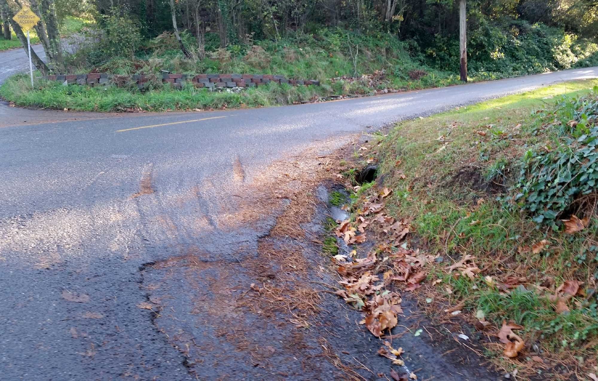

Pothole/culvert hit
This is what bent the axle.
It is an inside cambered turn and it was wet.
That looks more like a ditch! Send your bill to the County...
