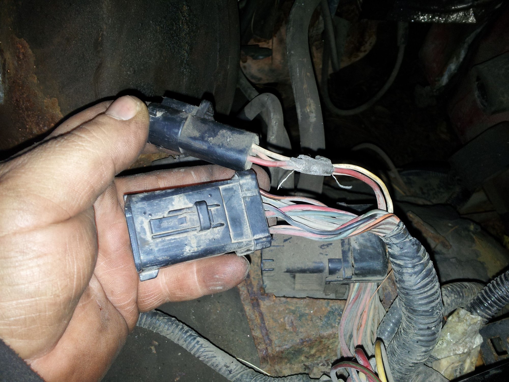

Hello all, I am doing a cab swap, both trucks were 1995 diesel F-350s, one was two wheel, and one was a four wheel. Two wheel was a standard trans and 4X4 is an automatic E4od. Final truck will be a four wheel.
The question I have is the wiring that runs down the frame towards the rear, the four wheel frame had an extra plug that the two wheel cab doesn't have in the harness. It's a 3 wire plug with an orange, a red and a white wire in it'
I can't find these wires in my Chilton manuals wirirng diagram. If I absolutely have to, I will change the harness, but I would rather not
Does anyone here know what this plug is for? I am adding a picture, the plug in question is next to the thumb in picture.
Thanks for any help anyone can give me.

I think the plug in question is for a trailer wiring harness but I'm not absolutely certain.

I'm thinking it may be for the 4X4 and low range shift lights in the dash.
Thats actually was what I was thinking.
