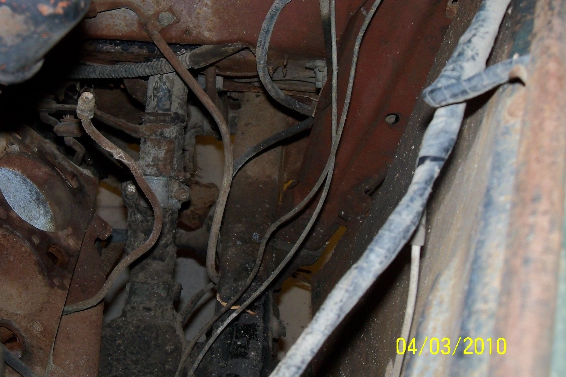

Here's a couple shots from my Mercury. Maybe they'll help. One shows the fuel line coming up from under the frame rail and attaching to the firewall. The other shows the line attached at the firewall and the hose running up to the fuel pump, along the left edge of the pic.

That looks like the line to my I6 - along the DS frame rail, under the radiator support, and to the fuel pump on the PS.
