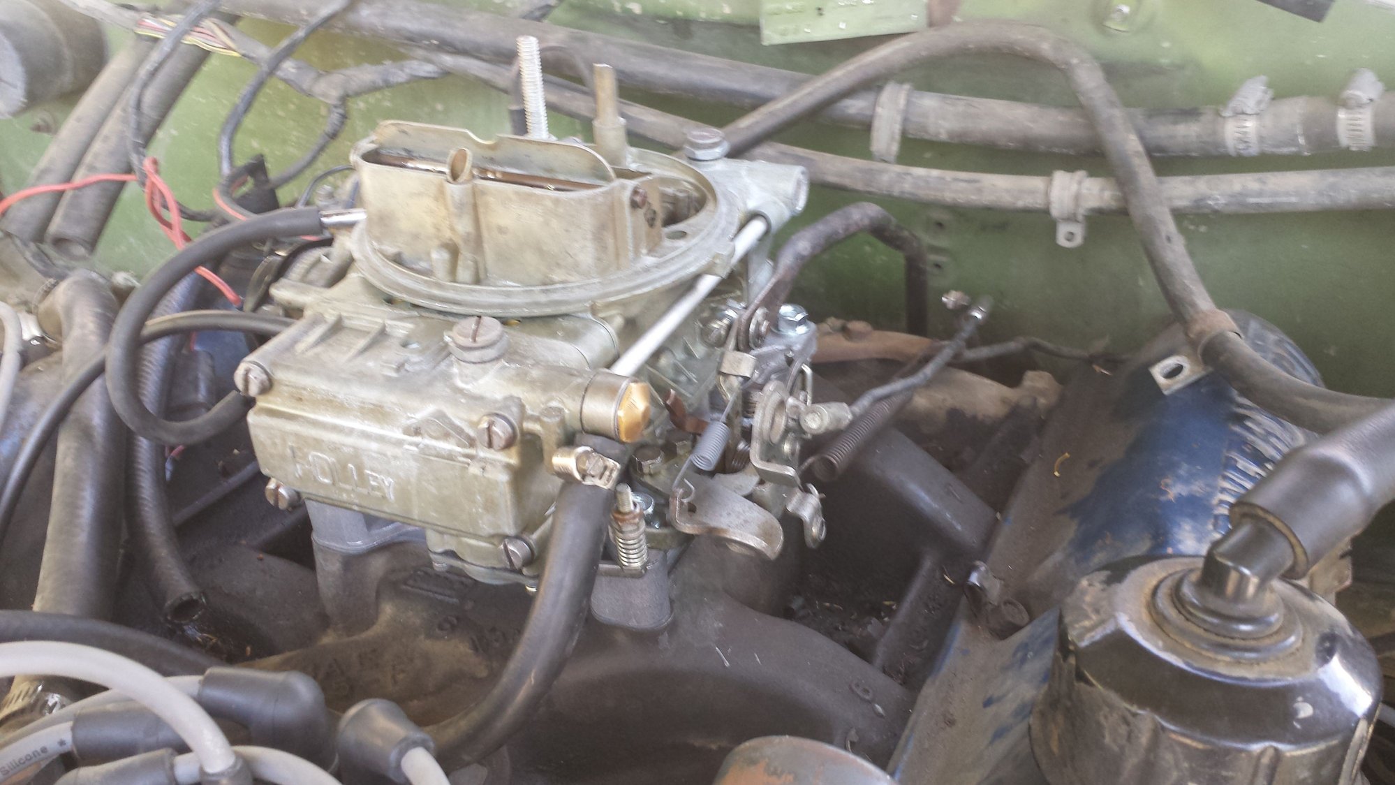

Originally Posted by turbohunter
Glad to help.
A little more info to complete the picture.
In the choke housing mount there is a small passage to the carb throat.
This creates a vacuum signal that pulls cool air into the housing through the bottom inlet to keep the bimetal nice and cozy. On your carb you have a nice fresh air source to attach the inlet to.
On other carbs and with no fresh air source you leave it open to the engine compartment.
Makes total since now, when I rebuilt it, I saw the vacuum port for the choke housing because I put a fresh cork seal on it. While I was putting it back together I kept thinking "why is there vacuum here?", now I know!

Got it Running! Mounted the carb, adjusted the floats, set the idle mixture screws (pulling 20 inches of vacuum), set the idle screw, adjusted the kick down linkage, confirmed the electric choke works and ball parked it’s setting. Have few little details to work out. Need to fix the throttle linkage, I used a temp fitting and I need to get the right size pivot post to use the OEM linkage. I’ll have to set the final linkage so the butterfly’s fully open and WOT.
Also need to sort out the PCV hose to carb fitting, not a big deal but it needs to be fixed. I was able to take for a little test drive up and down a nearby side street. It ran pretty good, better than expected!
Two more jobs to do and it’ll be streetable, got to sort out the gas tanks, the fuel gauge and related wiring. Not sure what all went on but a functioning gas gauge is a must have LOL! The other job is the radial arm bushings, ones completely gone and the other is falling out. After those two jobs are done, this truck is ready to be pressed back into service carrying household loads to and fro!
