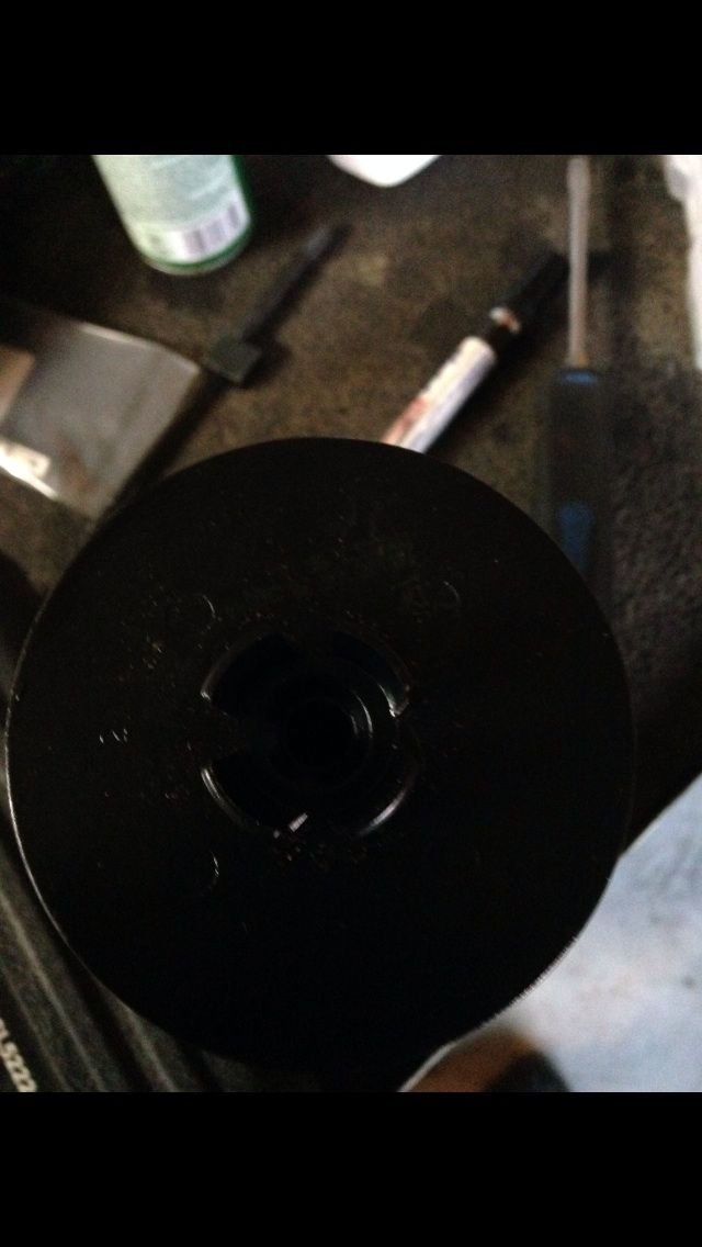

was driving the truck home from work and all of a sudden it just shut off like the batteries died, then tried to start it and it did not want to turn over, towed it home then took it to mechanic the next day and said my LPOP was out and I needed a new one, so we replaced that and noticed the screen on my IPR valve was busted so we put a new screen kit and changed the oil and oil filter and ran it and it shut off again, took the oil filter off and noticed shaving on the oil filter????

Shavings on top

I hate to say it but it sounds like the LPOP went out again.
I would beat you lost a needle bearing out of a lifter and it went through your LPOP.

Well after pulling out the LPOP and looking at it close up u can see the scar of a needle bearing getting crushed and pushed threw it, so I'm pretty much screwed, thank god for a back up 6.0 motor we will we be pulling motor dropping the pans and swapping the top of the motor cam, lifters push rods etc... Checking and confirming that's the problem which were 80% sure looking at the LPOP....
