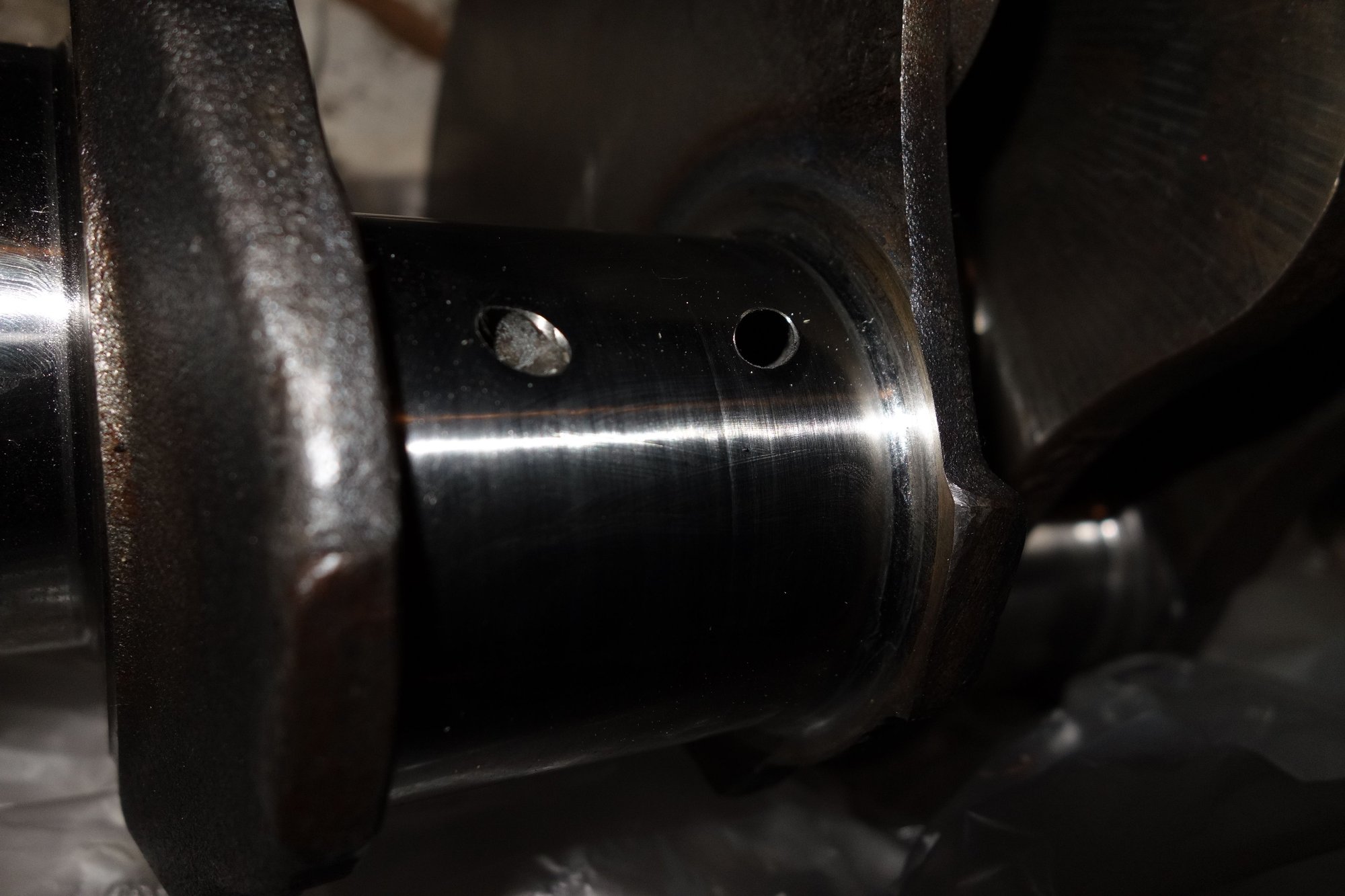

I had my crank turned .010 and It's easily the worst crank turning I've seen yet. You can feel and see lines and high and low spots in the work.
Can I just buy another crank and have it turned by another shop or have this one turned .010 again by another shop?

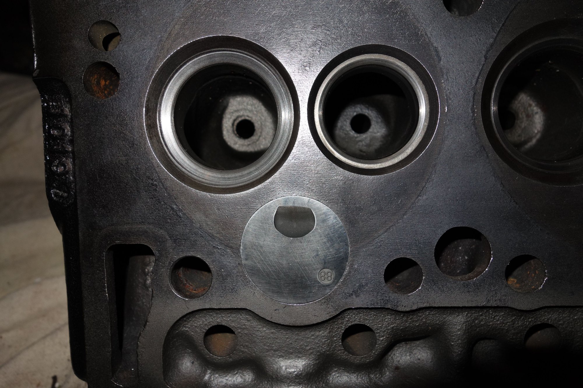

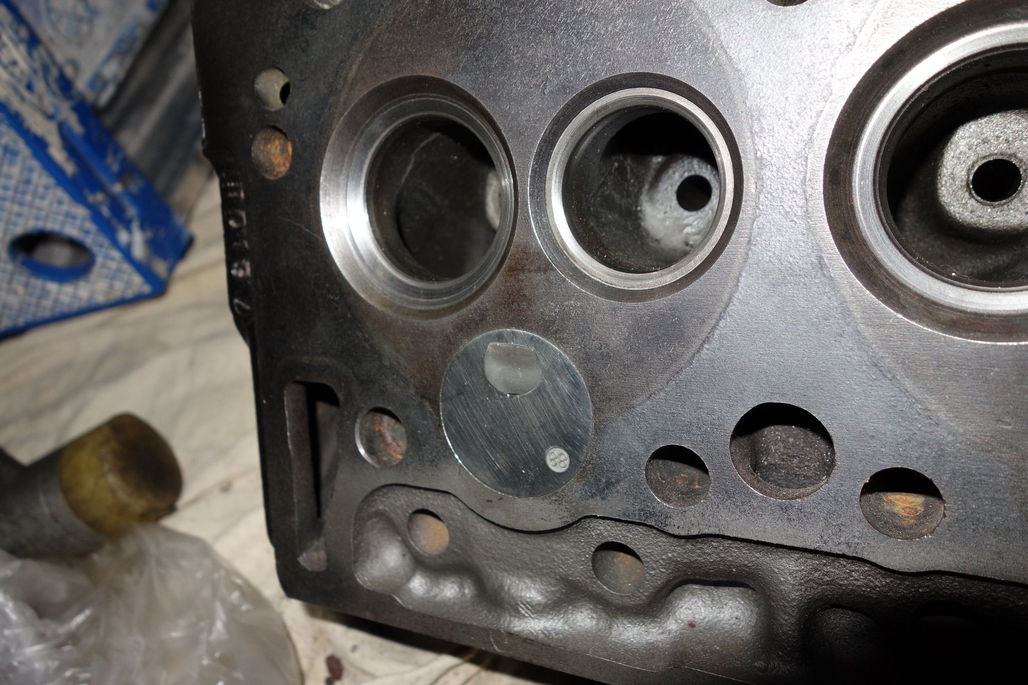

The other pics are of the heads. They just cleaned em. I stopped them from doing any work to them. Taking them to another shop. I currently have $5000 in my hands right now and need some advice in general, like where do I buy 7.3 IDI Turbo pistons? I can't find any.

heads look good

Take to another shop and have them measure. They did NOT turn that crank based on the pics, I bet they ran some crocus cloth over the journals.
I would not go 20 under.
It does not look turned to me either from what I can tell from the pics... although if they are going to pull that, I wouldn't take it back to them to have them re-do/do it.....

If they turned it they didn't polish it afterwards.

Take a dial caliper, measure it, and compare it to stock spec.. That will give you an idea whether it was actually turned or not and allow you to decide which way to go.

Looks cut rather than ground. If within spec, I'd probably just make a pass with fine emery cloth and use it. Irregularities in the parent material will give that striped look when cut with carbide. Especially if the last cut is a very small cut.
