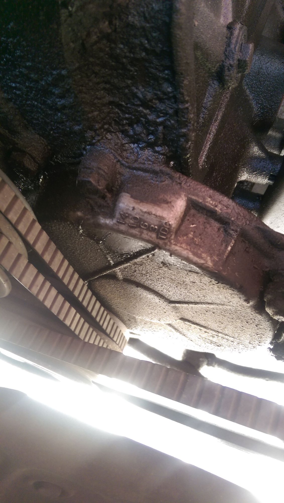

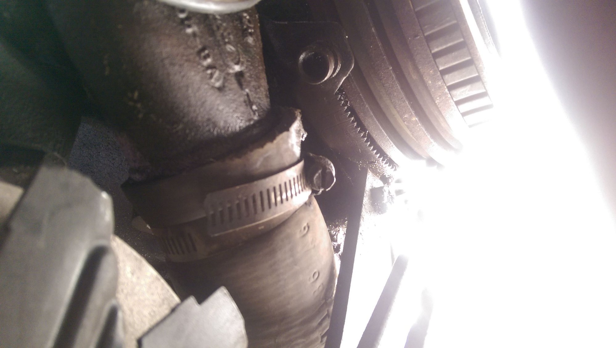

When we went to stick the timing light on my truck we noticed it had two scales for timing. One on the drivers side timing cover and another on the passenger side.
Driver side scale
Passenger side scale
Our cure for this was to set the timing by ear.

I would verify which scale is correct, and the best way to do that is with a piston stop or something like a straw stuck in the plug hole. Once you know which scale is which then determine what your current timing is, but make sure you get the idle to less than 1000 or the mechanical advance might be creeping in. And, make sure the vacuum advance is disconnected.

I will check the timing again. I believe another issue I ran into was multiple marks on the pulley and I didn't know which to go by.
