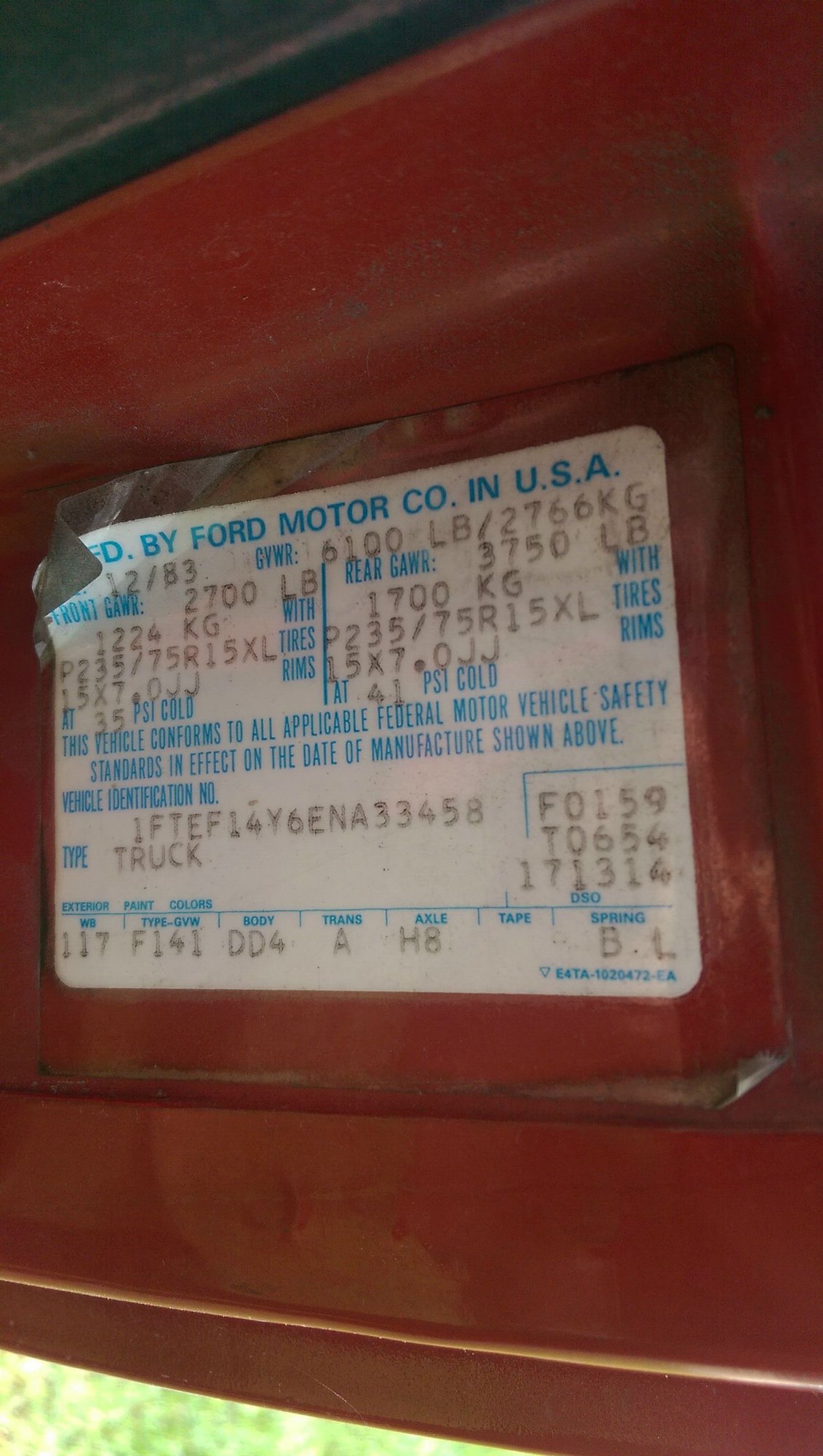

I know its been a couple of weeks so I figured I would give an update. As for the timing that has been put off for probably a couple of weeks. I need to source a timing light and the help of a good friend. Also currently it is my Daily Driver the mustang is down for some repairs. I didn't want to start messing with it just in case I did something and then it wouldn't run right.
I have worked on the truck though. I bought new shocks for all four corners and I sourced an interior light from the local junk yard. Its probably the piece I've been most excited about getting.
I also promised a few pictures for the Richmond race and I have a picture of my door label just for reference.
Door Label
