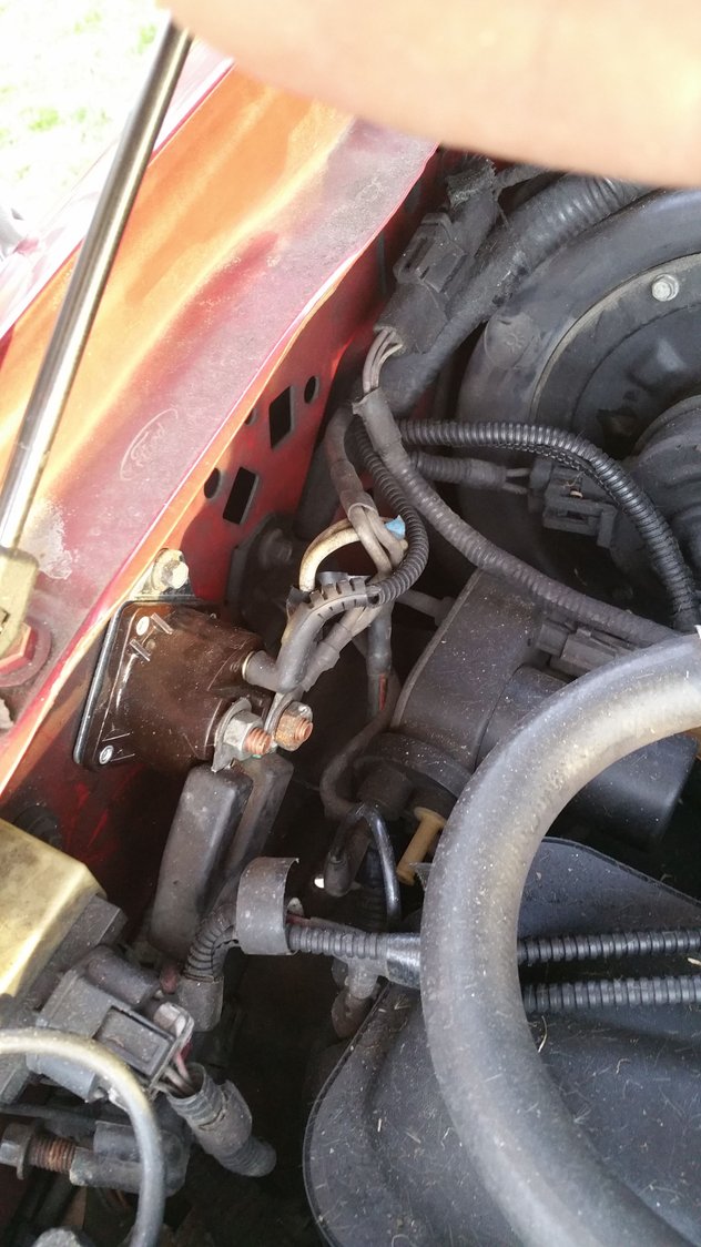

Long story short I swapped my 01 motor with one from a 96 e350 with 100k. Well putting it back together I neglected to label 1 wire... apparently the glow plugs to starter solenoid(at the starter solenoid). I put it where I thought I took it off of (the big post closest to the front of the truck) and after priming it up and some long strong cranks she ran choppy and then threw the ses light. I shut it down and for whatever reason, my smart *** switched the glow plug wire to the opposite post on the starter solenoid. After trying to start the truck... with a lot clicking, light flickering and slow cranking I switched it back to the original position Now I can't get her to crank...? I installed a new starter(reman) and solenoid and still just get a half of a crank and clicking.
What could I have done? I believe the ses light is another issue however I need it running to pull the code (s).
Any ideas guys?

Posts: 60
fixed
Originally Posted by pechroc1
So it seems my glow plug relay is shot. I ohmed out the the glow plugs at 1.0 thru the vc harness. I guess that means theyre good. The noise im hearing is like a cupping sound coming from the intake. I never heard this with my old motor. I also never cranked it with the intake spyder off. Has anyone else ever heard this?
I definitely didnt make that sound before I shorted the gp solenoid/relay.
So just to update for anyone as forgetful as I am here's a pic how what poles the wires go on in this year truck.
