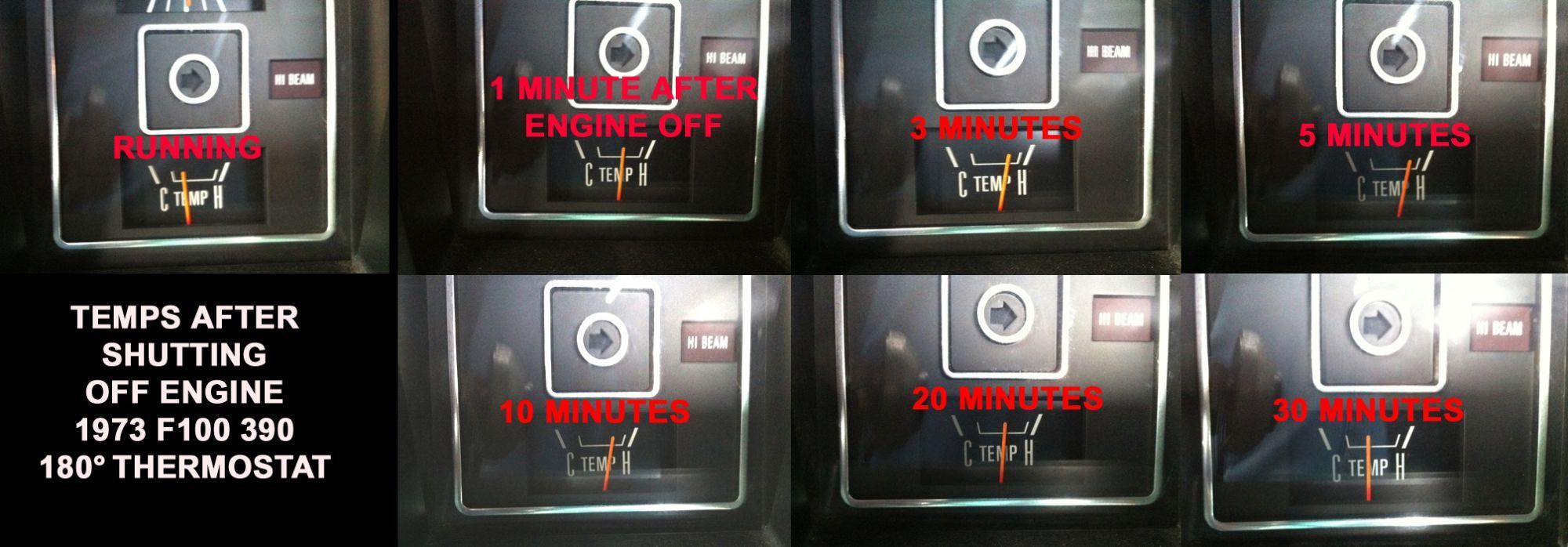

Anyway, the last few days it's been starting up fine, but still idling poorly after it's warm. It has been staying at normal operating temps when running but really spiking after I shut it down. The old thermostat opened at about 195°-200°, based on checking it in hot water on the stove. I replaced it with a new 180° thermostat this morning. It's running temp is a bit lower, but it still spikes after I shut it down. I know that heat soak happens on all old trucks but I don't know if the spike I'm seeing is in the normal range. It nearly pegs the gauge a few minutes after shutting down. With the old thermostat it did peg the gauge. I'm beginning to think my starting problems are caused by this, and maybe its also affecting idle? Doesn't seem like it should be because once I restart the engine it cools back down in 10-15 seconds. Here's what the temps look like running, and after I shut it down. Normal?

Sounds like you have several things going on.
The heat spike after shutdown is normal for an iron headed engine. As long as it cools down after a minute or two of running, no problem.

Get an aftermarket temp gauge so you can get a better idea of what your temps actually are. That factory gauge is so-so at best.

Yeah, I hate these "my factory gauge is overheating" posts.
get an aftermarket water temp gauge (mechanical) and see what it actually looks like.
