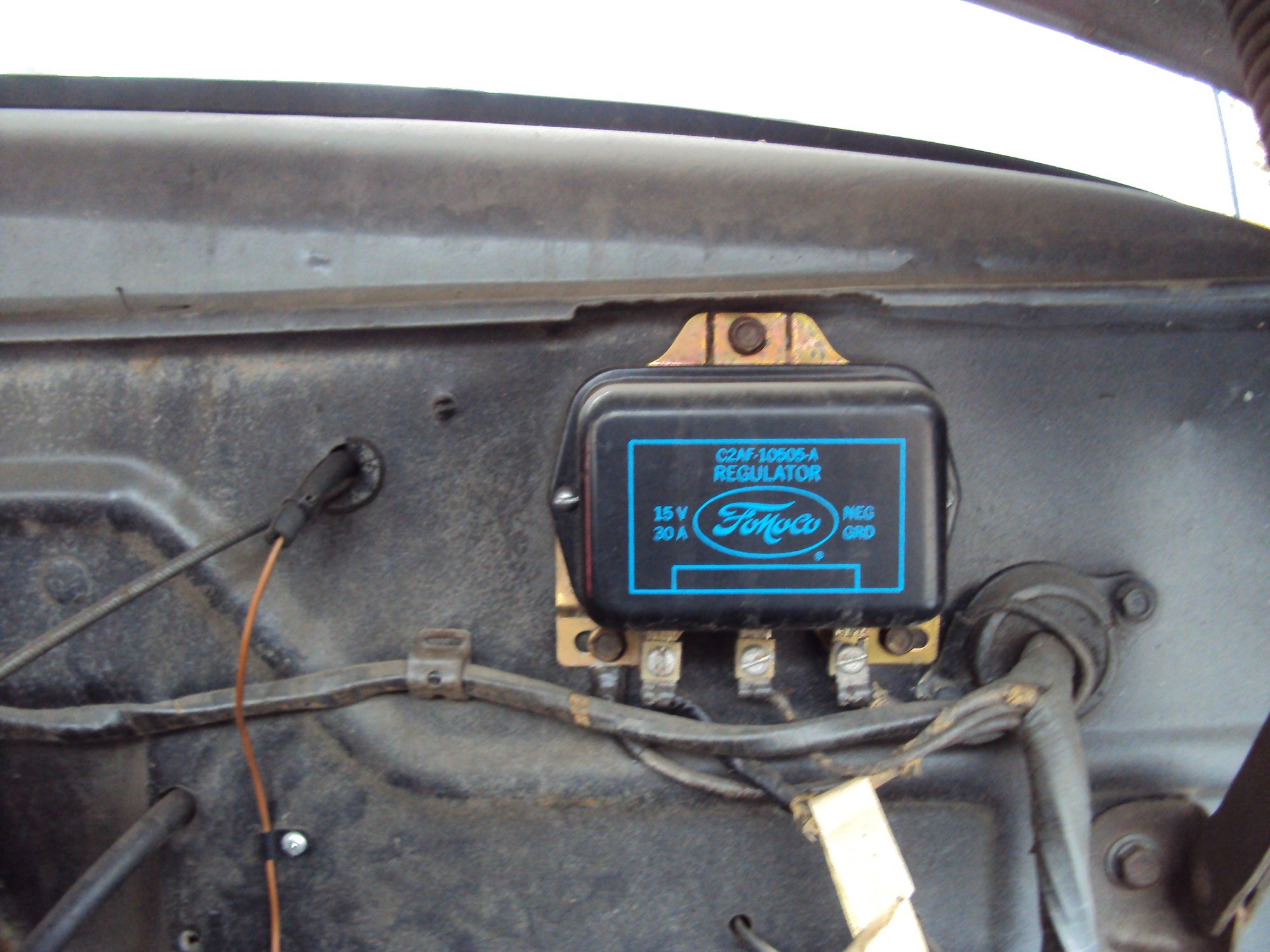

OK... so what happens if it's a 6V generator, 12V battery, 12V coil and 12V head/tail lights?
I assume the regulator is 6V unless it's been changed???
I have a feeling that someone was trying to upgrade it but it was never finished. The dash lights are dead and it has a 6V flasher.
Do I finish the 12V conversion or go back to 6V?

It's a 12V regulator.

Been meaning to ask - my truck regulator is like the one pictured. There was at one time, a plastic snap on insulator that covered the terminals. Does anybody offer those as a repro or something?
