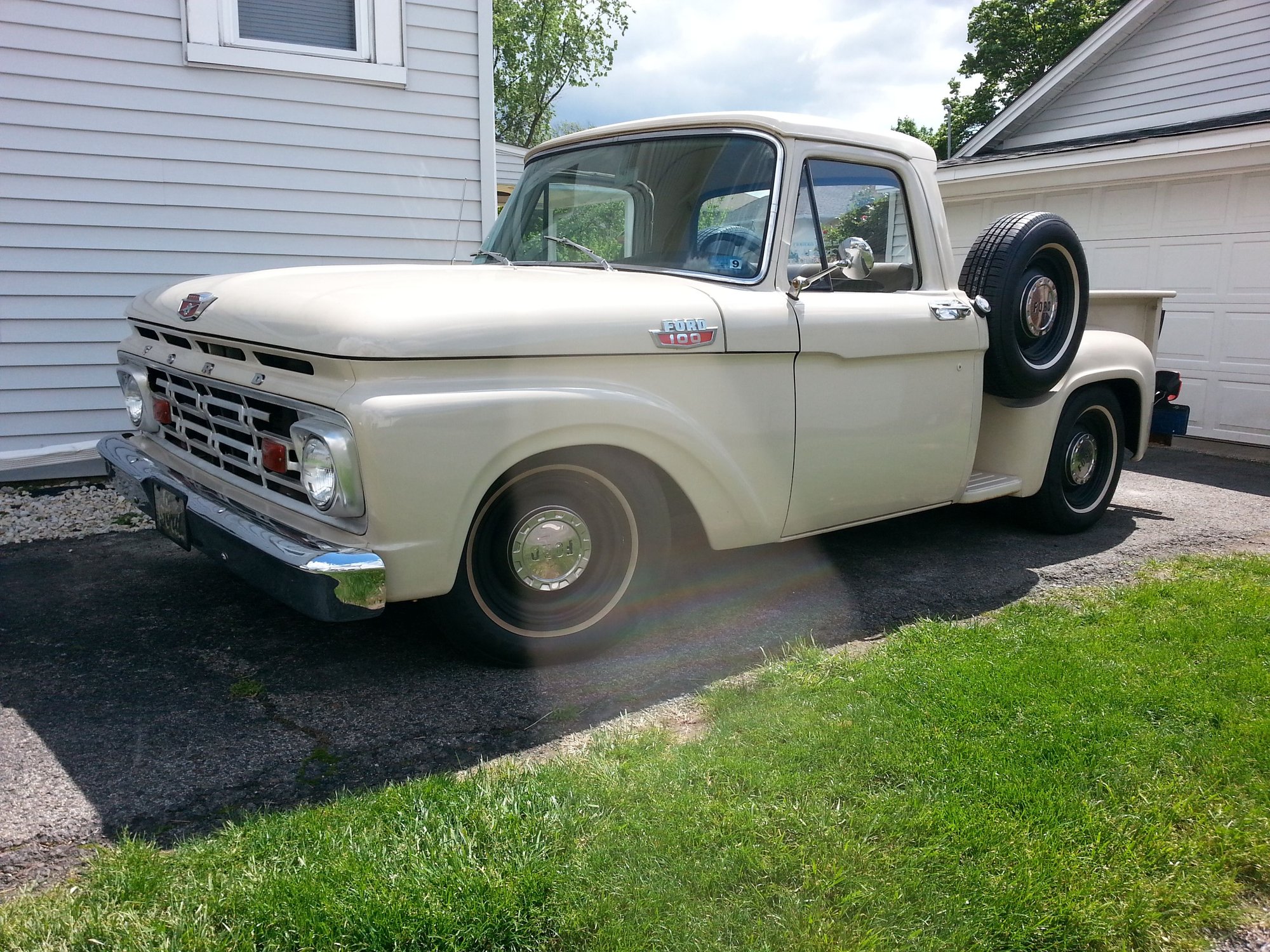

Lowered mine this weekend using the method that Jim outlined. It was a pretty easy and fun weekend project. So far I'm pretty pleased with how it turned out. I'm not sure how much it lowered the truck, but it's definitely a noticeable difference.
Thanks again for the help, Jim.

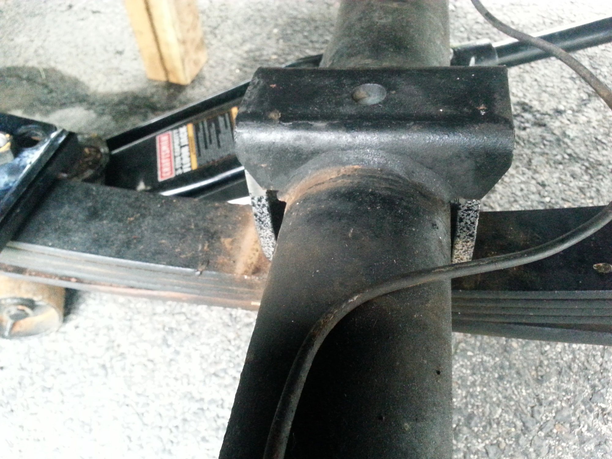

I know this is almost a two year old post figured I would comment on it. I am in the middle of trying to lower mine. I am very curious why a flip kit is only available for 65 & up and not for 64??? I was thinking of making my own flip kit. Just putting the rear axle on top of the leafs gives you a six inch drop. The flip kit was listed for by djm but is a quarter inch too short. I was thinking of welding on a shim or something. I just was really curious on if it could be done. I am thinking of just starting over and doing this leaf flip of #4 enstead. I have hardly no room for travel now.
Old Jun 20, 2016 | 11:16 AM
TWONY's Avatar
TWONY
Joined: Jul 2014
Posts: 57
Third times a charm!
So, after quite a few weeks of one after another leaf spring modifications I am finally on the right track. Lesson learned, research is key and this young buck didn't do his before I started trying to lower my truck like a ripping a condom open on date night. Couldn't get it done fast enough.
Round one: I did an axle flip. Literally put the axles (front & rear) on top of the leaf spring purches. This lowered it extremely, hints the previous pictures I posted. I would say 7-8 inches. The down side is there was no room for suspension travel. The steering was terrible. I would not recommend anyone doing this without proper medications being made.
Round two: Took everything apart again. I did what Jim said along with the H.A.M.B. journal link provided. I used a threaded bolt to run down the third longest leaf front and rear on a reverse arch to somewhat flatten out the eyelets bringing down the ride height. I ended up with about a 3 inches in the front and 4.25 in the rear.
Round three: My second go round was a good result, BUT I wanted more of a raked look vs the level look. With my stepside it is more noticeable in my opinion. I am putting 2 inch blocks to raise it up in the rear.
My whole purpose of starting this was I was tired of that tip over effect I got with every little turn. It rides alot better now, I have notice a little bit of bump steer but I only put maybe ten miles on it so far. I do have to realign it, the steering wheel is slightly off. I hope this helps someone, trial and error seems to be my way but man did I lose a lot of time doing this project. I finished it before Father's day and took my son out in his power wheels Mustang in an empty parking lot. Thanks again FTE for the assist.
