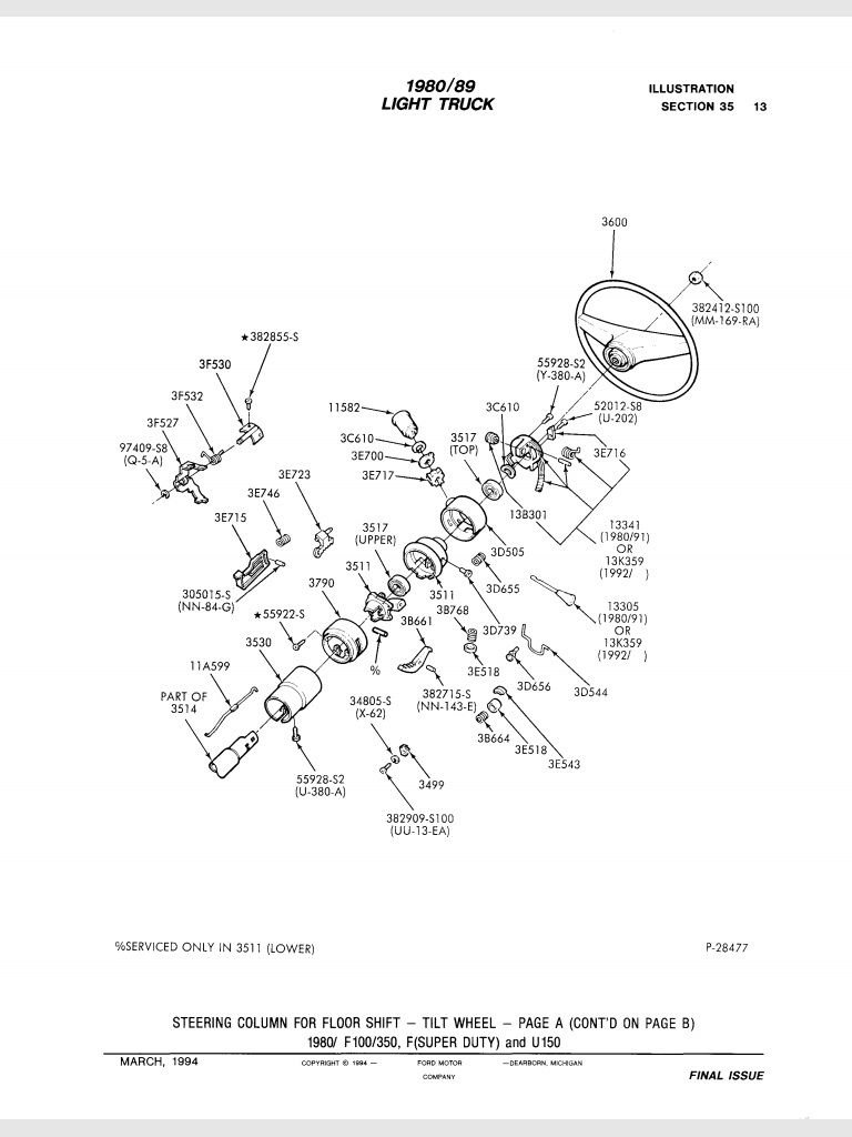

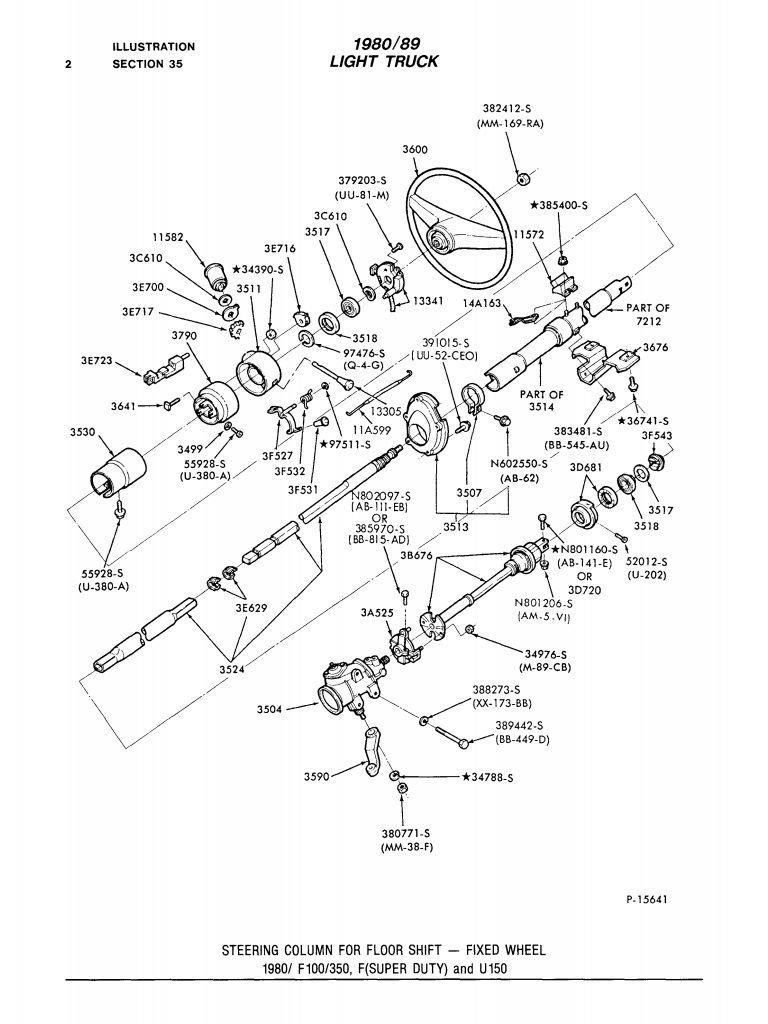

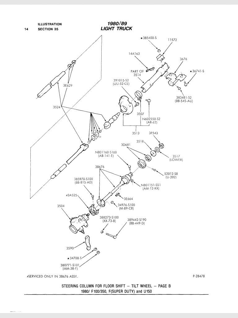

Here's info on the floor shift versions, but I'll look for the auto versions later.

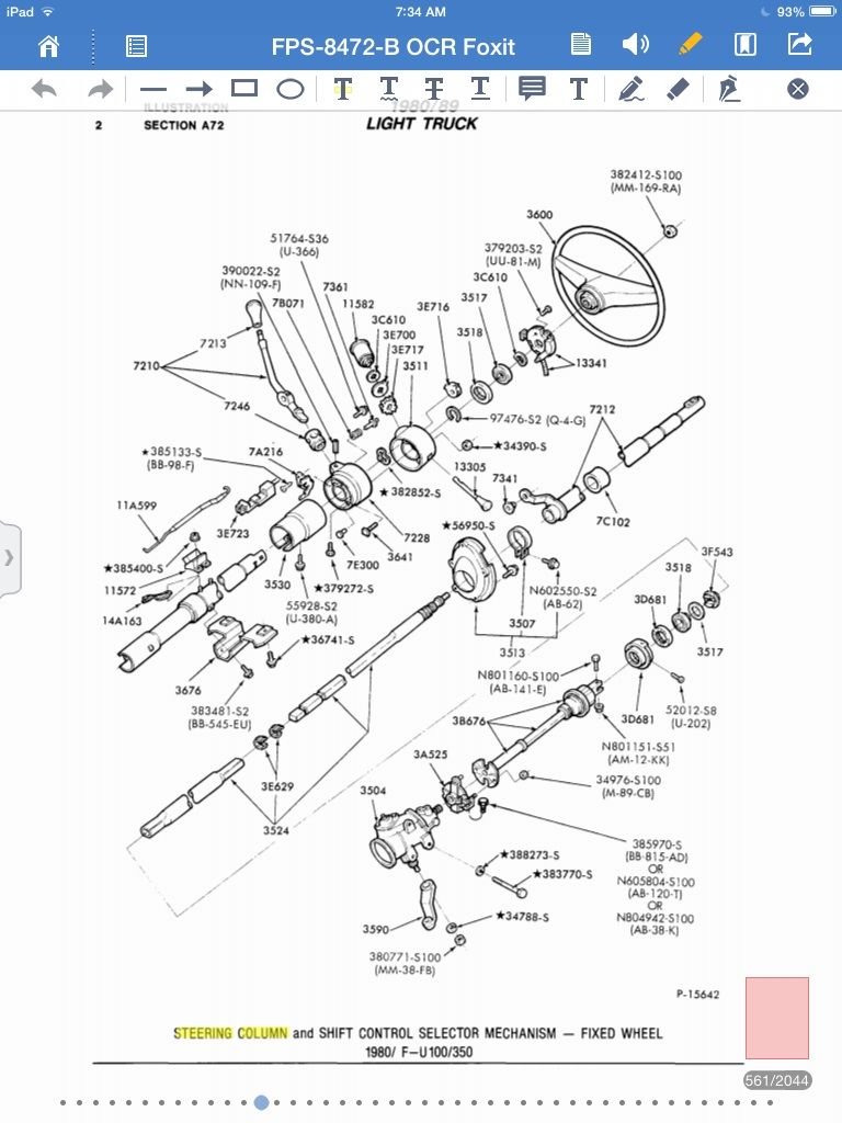

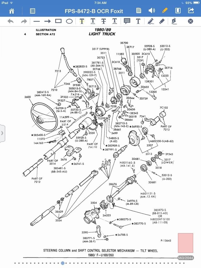

And here's the auto trans columns - I hope
