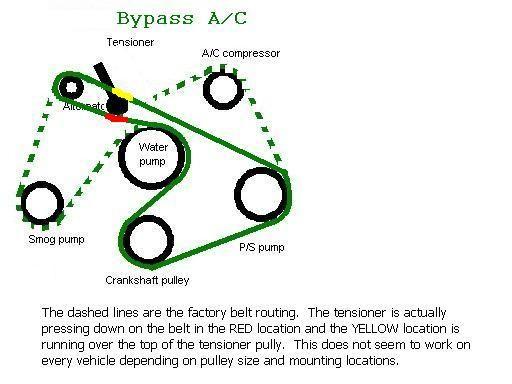

Just don't bypass the smog pump. get a string and measure for a new belt since it will be smaller. On my truck I bypassed the smog pump and it works just fine.

Right now I'm only bypassing the smog pump. That was the quickest picture I could find to show you the idea. You can just get rid of the AC and get a smaller belt. To find out a belt size use a string and wrap it the way the new belt will go and measure it. That's what I did but it you want to bypass the smog and AC do it just like the picture. If you search 5.0l belt routes it will show you different routes.
I'll see if it'll work on my truck, if so that'll save me $30 on a bypass pulley. Thanks!

If the new belt squeaks shim out the alternator with some washers.
