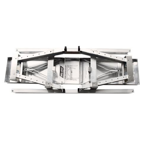

A sheetrock bench comes in handy to stand on in front of the bumper.
You can adjust it to the right hight and with something to lean on and
cover the hood latch it makes life so much more easy.
Lost of walking space and so many other uses. Just keep the wife away
of you will never see it again. Just too useful.
For easy storage just fold it up.
Sean

I like the looks of that... just put it on my list of things I need if(when) I have to tear into this thing again.
And if I've got anything extensive to do, that latch gets unbolted. And I'm going to start popping the grill out too - just 4 screws and it's out. It really likes to grab the boys and rough them up a bit when I'm sliding down the front... although that bench would probably stop that.

Yes it does stop THAT!
