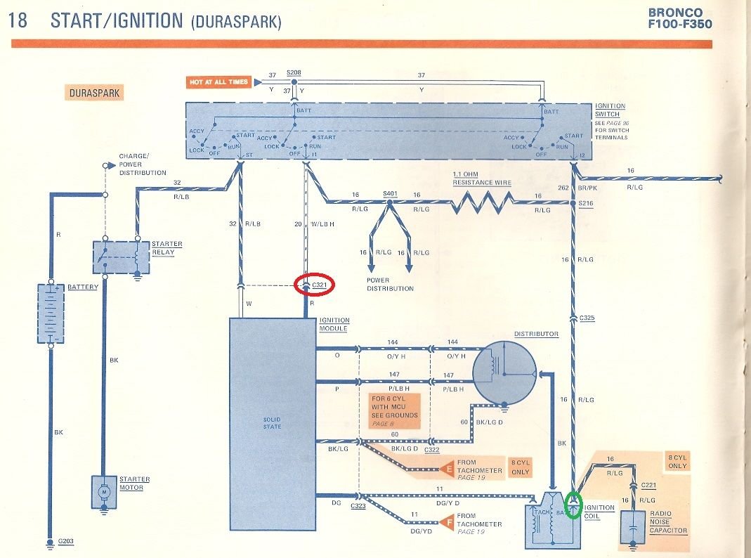

Got an F-150 , 1982 300 inline six . Anyone know the value of the capacitor that is screwed to the sidewall with the regulator ? And is there supposed to be another one somewhere else , like at the coil ? I'm probably going to replace the voltage regulator . Is there one type that's better than another ? Thanks

It is just a radio suppression capacitor.
You will find one -either or- but not at both the coil and the regulator.
0.50 microfarad is common for this application.

Oddly enough, only the 8 cylinder engines got one at the dizzy.

Lots of people wonder what that single gray connector at the horseshoe is for.

Yup. Look to the left and up from the green circle on this from the EVTM: EDIT: I MEAN TO THE RIGHT.
